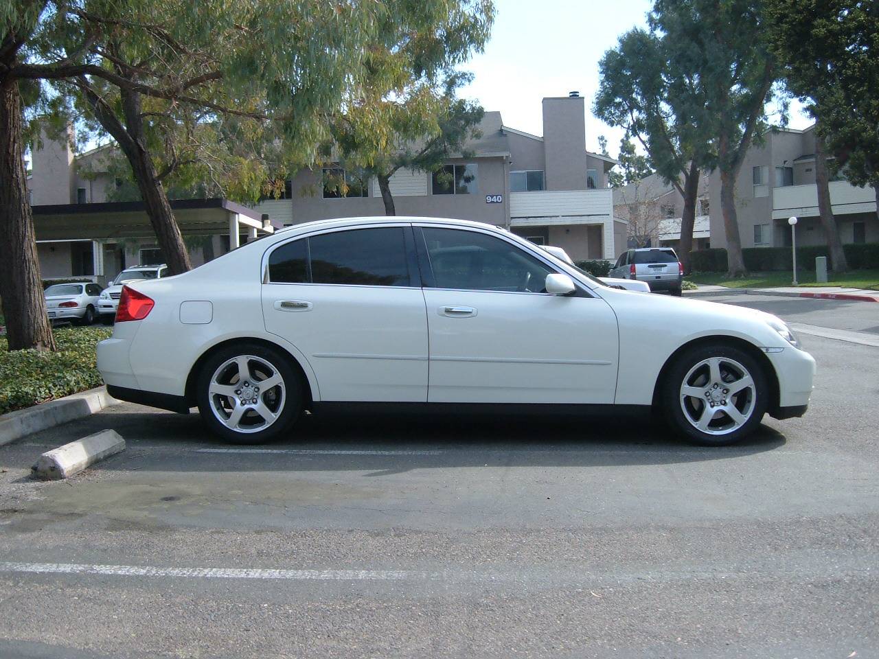

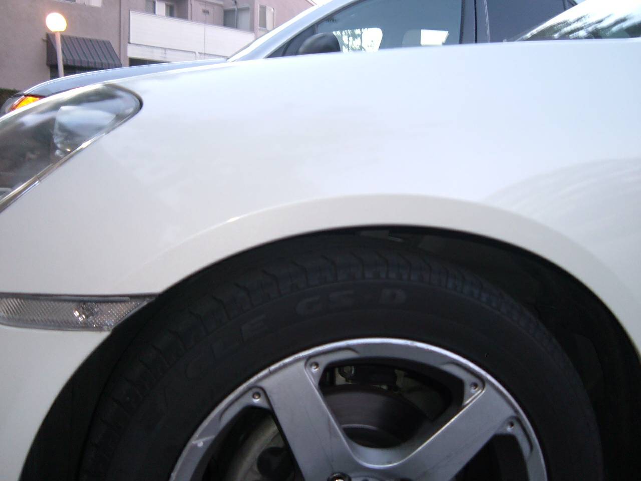

Heres what mine looks like with unrevised Z springs and 235/45/17s. I sure noticed a difference

<img src="http://www.imagestation.com/picture/sraid225/pb67cbb4bafa6e92a5937bea0cc7a3fb5/ea2e3845.jpg">
<img src="http://www.imagestation.com/picture/sraid225/pe0beaca5cd176cdfeb1e5fbf1745e865/ea2e3844.jpg">
<img src="http://www.imagestation.com/picture/sraid225/p40f88e29853f7aed7908f1bab91471f1/ea2e3841.jpg">
<br><br><br>
Here are a few pics of my car after putting on the unrevised z springs. I'm running 245/40/19 and 275/35/19 (8.5 front and 9.5 rear, +43 all around) with Maya STMs in a graphite machined finish. No rubbing with 4 people in the car.
I'm not too sure about the problems you would run into using revised shocks and unrevised springs. I think you should go with one or the other instead of mixing and matching. Hopefully someone could chime in and give you some better advice. I went with the z springs because I wanted a conservative drop to go with my sport suspension.
