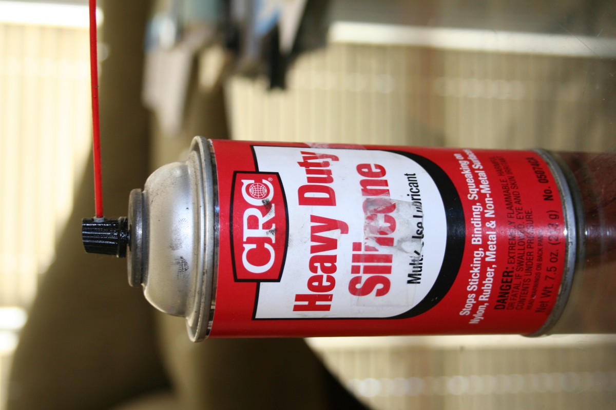

added pictures
I have attached pictures of: the silicine spray I used, compression rod view, bushings of rod connecting to the frame with lines showing the spraying points (2 pictures), bushing attached to the wheels with lines showing the spraying points. So far everything is quiet.

I just sprayed mines before you posted up pixs I actually ended up spraying my springs and I'm hoping I got the compression rods as well... It's too dark down there but I don't hear anymore noise. I have my can of CRC in the trunk so if I hear it again I'll give it a couple sprays. Thanks for the pixs though they really help give an idea of where the rods are.
