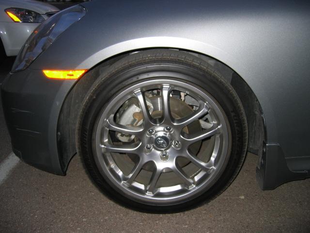

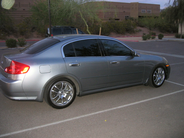

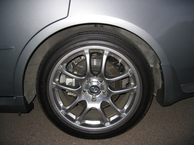

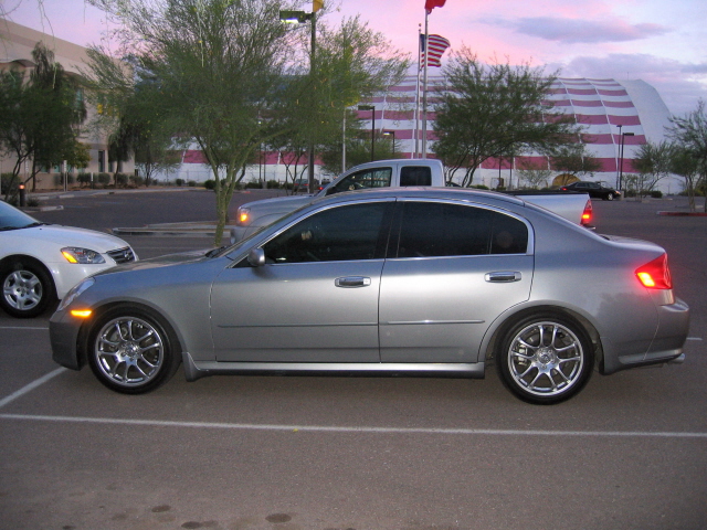

Here are some pics of my '06 6MT sedan on revised z springs. See, no droopy butt. Total drop was about 1" in front and 3/4" in back.

Wow, you weren't kidding. That's odd.
