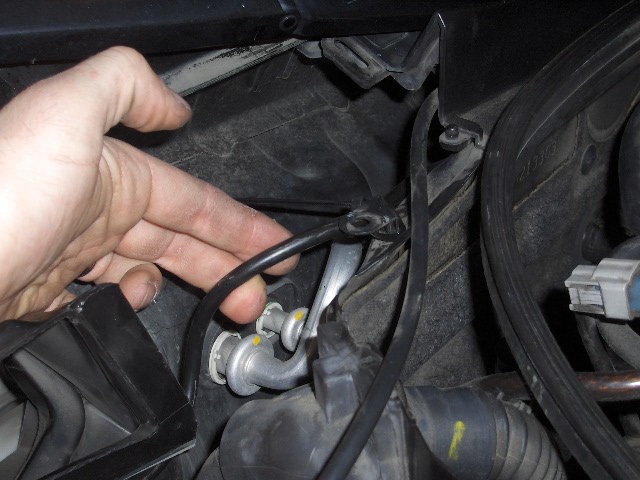

Front left first (driver's side):
So I ran the front left actuator plug through the rubber seal thing in the brake fluid compartment. (Pic1) I also taped over the plug so it doesn't get dirty while waiting for the coilovers to show up. Soon. . .finally.

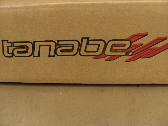

Next, I ran the wire in the space behind the engine and next to the firewall. (Pic2) It came out the other side next to the washer fluid line, and next to the air intake for the in cab filter. (Pic3)

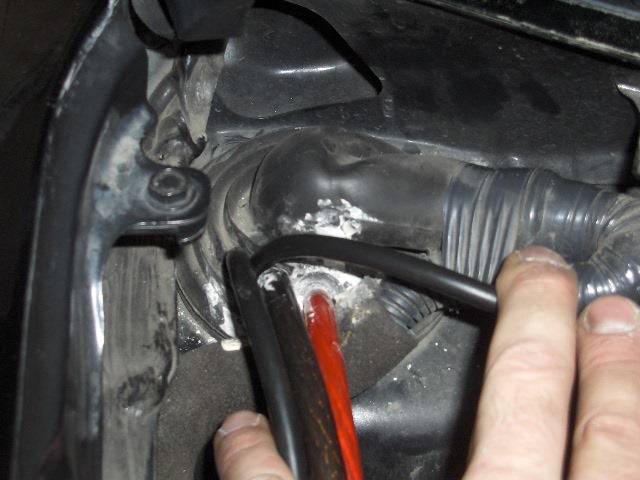

On the passenger's side front actuator wire, I ran it through the grommet next to the all too powerful grounding gear. (I swear, the GG helps! @self) I had to slit it, since it was too tight to poke the plug through. (Pic4)
Yes, I taped over it too until the actuators are installed.

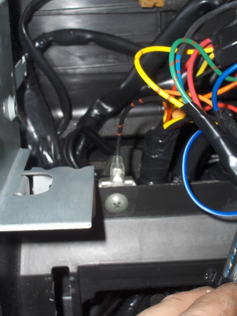

Pics 4 and 5 show the ground wire with it's fork connector. I probably should have tapped this into the wiring harness too, but didn't have wire cutters with me, so I just pinched it in at the point shown. It works just fine--as far as I know. When in accessory mode, (engine not on) the TEAS will tell you the voltage level, and it always says 12.6 or so. And when the engine is on, it does its thing. Maybe I'll take a video of it's power on sequence. Nothing too fancy, but kinda cool none the less. Anyway, I pushed the fork connector back as much as possible, and it doesn't get in the way at all.

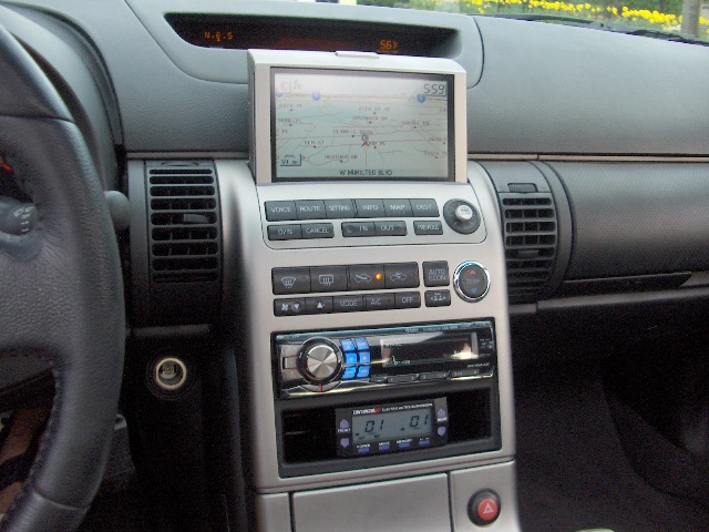

Last pics. . .
I cut a hole in the double din pocket I bought and ran the front/rear/power wires up into it and ran the rear control wires under the center console to the back seat for now. I didn't take any pics of the din pocket or the hole size, but it was basically the middle 1/3 of the pocket, bottom to top. The dremel worked great for it. The first pic shows the backlight off. Second shows it on (sorry it was still bright) and the last shows the final view for now.
I'll post up more pics when I take pictures of the rear cable routing, and when I install the coilovers.
