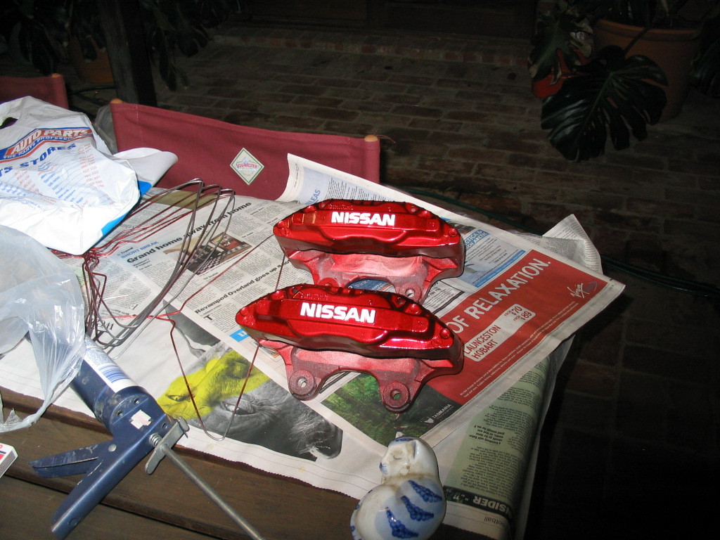

Here's a couple of pics of a used set.
Front
Rear
Front painted
So not a BBK, but BTSCBK (bigger than stock cheap Break Kit)

Heard back from the guy who was giving it a shot and unfortunately he took a quick look and concluded that it won't fit "easily" didn't quite say exactly what the prob would be, but I think he's decided to go for a traditional BBK instead.

Sorry, already tried...
Front calipers do not fit.. you will need to use a spacer to have the caliper placed properly... also the rotors that are the size for the calipers are the wrong offset when used on the g35 hub / spindle...
