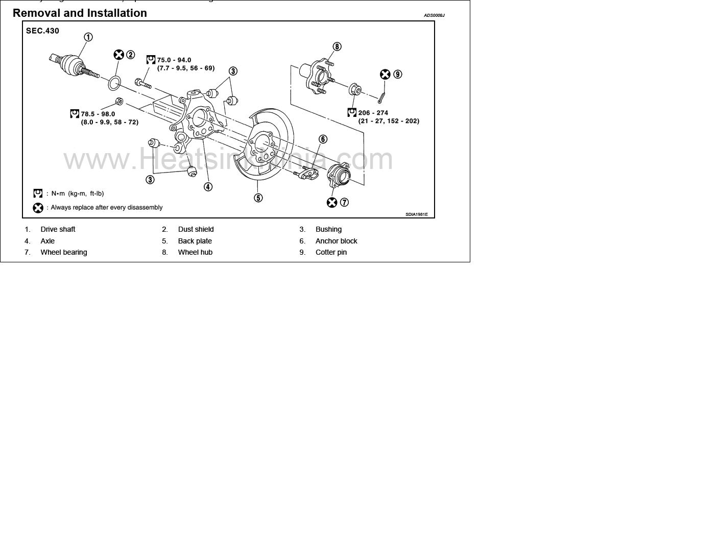

awesome, I think replacing the hub/bearing shouldn't be too bad.
- remove wheel
- remove axle nut & cotter pin
- remove caliper
- remove rotor
- unbolt hub
reverse installation for new stuff

MAybe this will help, unless you already have this info. =) Good luck
Attached Thumbnails Wheel bearing & hub - time to install these puppies-hub.jpg
