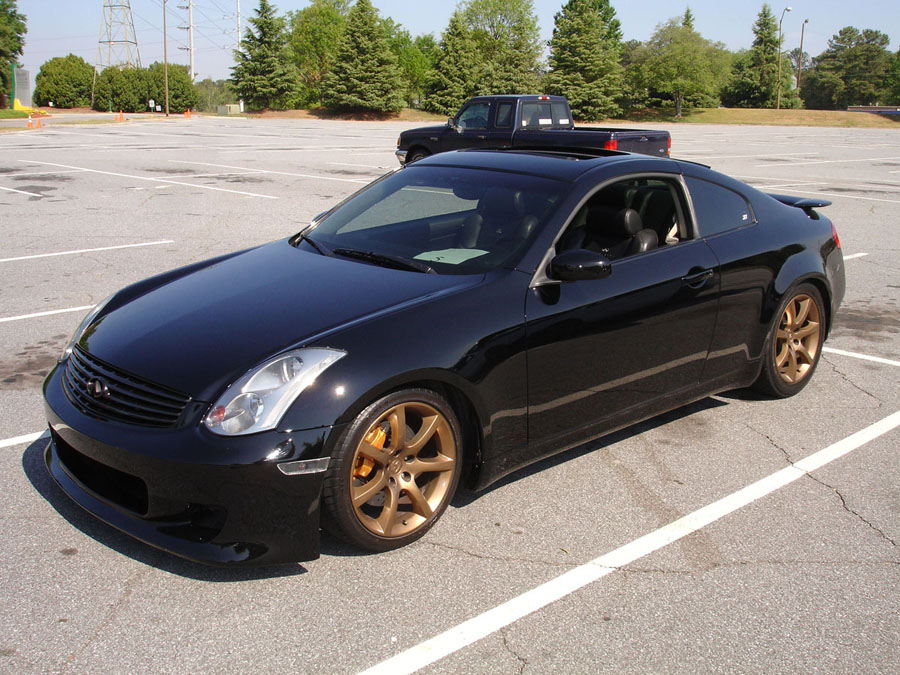

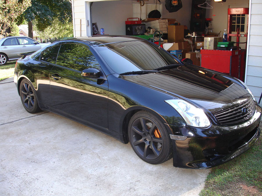

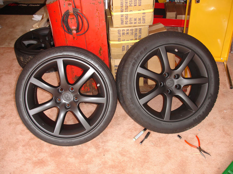

I have 2 sets of stock 18's that I have painted my self with high temp spray paint and high temp clear coat. I choose Flat Black and Antique Bronze. Each set took me about 4 hours worth of prep and paint time. I fixed curb damage and sanded off the gloss so that the paint would stick correctly. Then painted with spray primer, then 3 coats and high temp color, and 3 coats of high temp clear and allowed to dry for 2 hours between each coat and let them cure for 24 hours before putting them on the car. It was very easy and maybe cost me $60 to do both sets. There are a lot of DIY's on here to paint rims, just make sure that you don't tape off the tire, use note cards stuck in between the tire and rim. Hope this helps let me know if you have any other questions.
