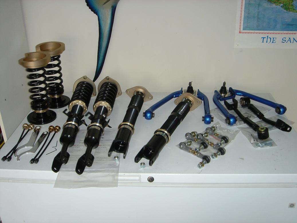

So I installed my BC Racing coilovers, PowerGrid end links, and SPC toe bolts last night. I didn't install the Cusco A arms because I didn't have the conical bushing, so I'll be going at it for round 2 this weekend hopefully.
I was wondering if people could answer some questions for me:
1) The end links just need to connect the sway and end link mount and elongated enough where the end link joints aren't twisted, correct? What I mean by twisted is that they are facing their respective surfaces without too much bend in either direction off the ball joint. After tightening the jam nuts in between the end link pieces, I don't need to do anything special to them besides this right? How do I adjust for pre-load and all that stuff? Is that basically what I am doing by adjusting the end links to a proper length?
2) I never had a sports suspension on a car before, but I've had air suspension. I am getting kind of a clunking noise coming from the back when I go over harder bumps. I remember my Denali w/ air suspension doing this too on rough patches of road, but I just wanted to make sure if this is normal as well on these types of setups. I don't think anything is loose in there, because the rear spring was definitely compressed back up in order to put all the spring arm bolts back in and etc. Maybe it's coming from the top of the shock? Which also wouldn't make sense if it were loose, since it's in there good.
Bottom line: is this noise normal when going over bumpy roads? (I have my dampers set at max hard.)
Attached Thumbnails Suspension Installed... but have some questions!-dsc01550.jpg   Suspension Installed... but have some questions!-dsc01562.jpg
You'll have to get the car corner weighted to determine how much preload you have dialed in at each corner. And how much preload you have really is dependent on how you want your car to perform at the track. With no preload, the only load on spring at static is the car weight.

go to this thread...there are pics of my power grids installed. you want the end link to be directly parallel with the sway bar and the attached arm.
with the height set the way it is now, you could remove the preload from the sway bars as is. to take full advantage of the coilover setup and adjustable endlinks, you would have to get the car corner balanced. however, if all you want to do is make sure all four corners are the same height, then you could remove the preload on the sway bars by adjusting the end links unti the adjusting rod is "loose" (meaning you could turn it by your fingers about 1/4 turn).
since the BC coils are in the OEM spot, do what Moog says and check all your nuts/bolts and make sure they are at the proper spec (and no, hand tight +1/2 turn does not count). also make sure that your endlinks are installed properly.
