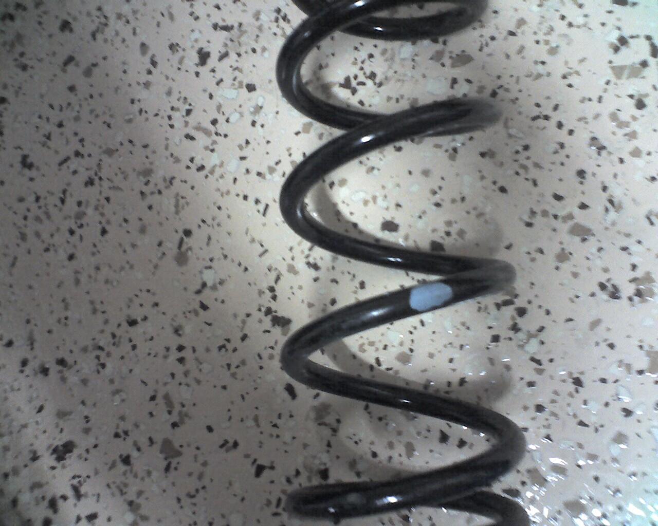

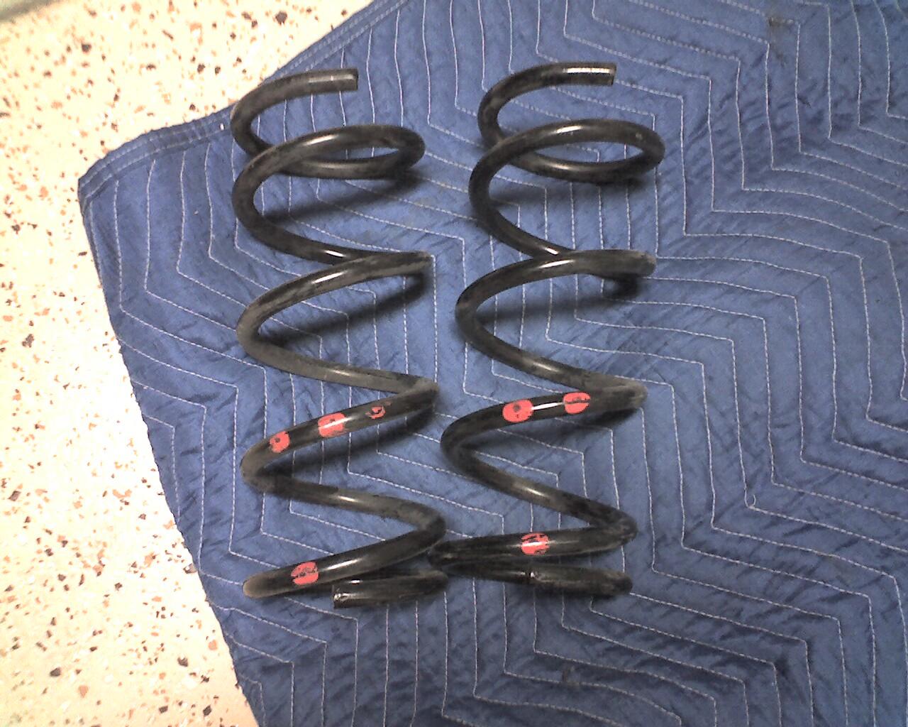

just purchased a set of 350z springs from a 350z roadster. i did a searched and the springs don't match up... help please... revised or unrevised, 350z?
Attached Thumbnails need help what type 350z springs-springs.jpg   need help what type 350z springs-springs-2.jpg   need help what type 350z springs-springs-3.jpg

They look just like my Unrevised springs, sam style and markings.

what color are the rears? the springs i have a blueish/white single dot. i dont know if you can tell in the pics. kind of baby blue. and i assume the 3 red dots are the fronts?

A 04.5+ Z REAR spring will have 2 red dot's and 1 pale purple dot. A 03/04 REAR Z spring will have either 2 red dot's only or 2 red dot's and 1 white dot.

ok... now im confused,
texas has confirmed that i have unrevised 305z springs...
but hybrid states those dot dont match up with my springs...
one set has 3 redt dots (2 on one coil, 1 red dot on another coil.
the other set set has 1 white(pale blue?) on a coil...
please clarify which is the front and back...,
and if they are revised or unrevised...
or even are they from a z or g...
thanks guys for help in advance..
