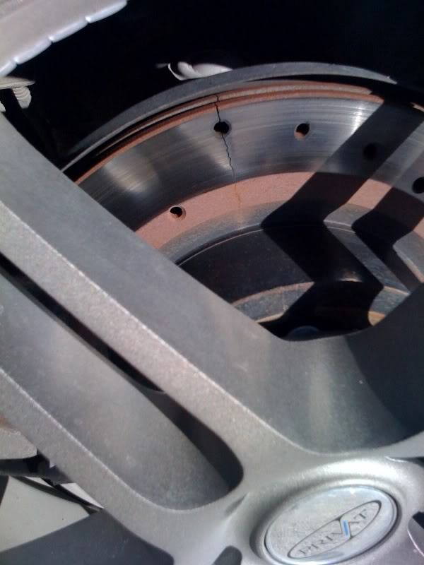

This is a StopTech drilled rotor, NO TRACK DRIVING:
They WILL NOT waranty Drilled rotors.

^ oh wow. Maybe you got a defected rotors? i never heard anyone cracking stop tech rotors before.

I called them and they said for this very reason (cracking), they do not warrent any drilled rotors.

They also say that when the drilled holes are all the way to the edge, that this damages the integrity of the rotors, thus causing the above picture^
