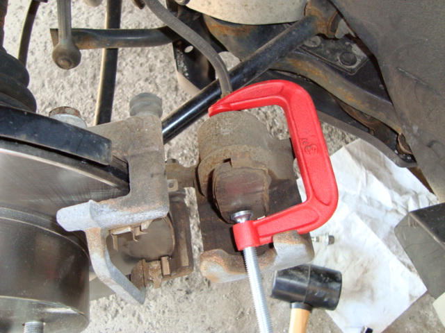

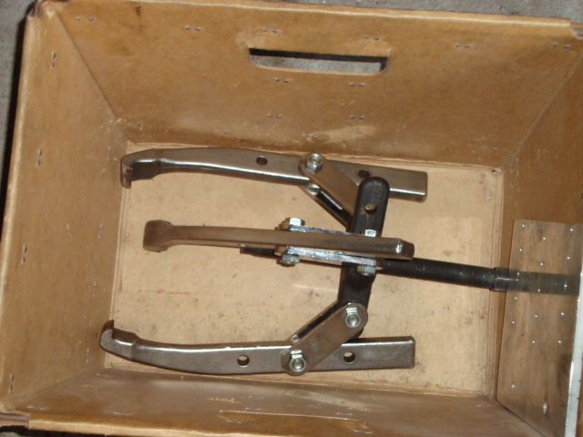

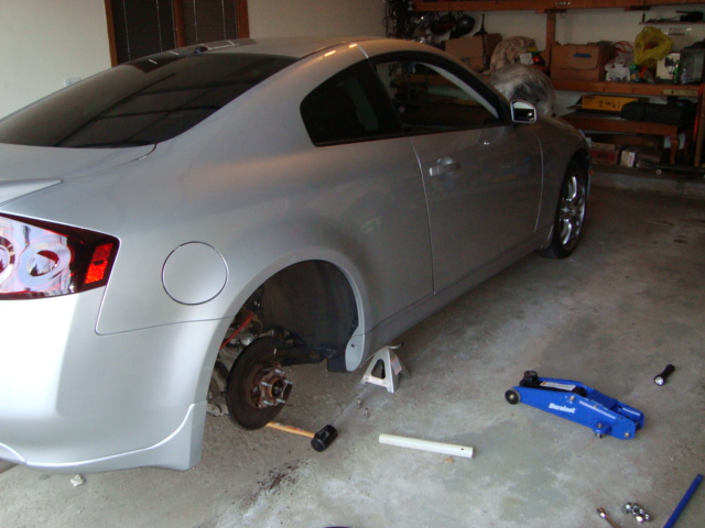

finally was able to get them old rotors off (with a gear extractor), and got in new rotors, along with new pads, took me about 6 hrs with the help of a buddy.
here are some pics.
enjoy...
Attached Thumbnails new rear rotors-dsc00017.jpg   new rear rotors-dsc00021.jpg   new rear rotors-dsc00022.jpg

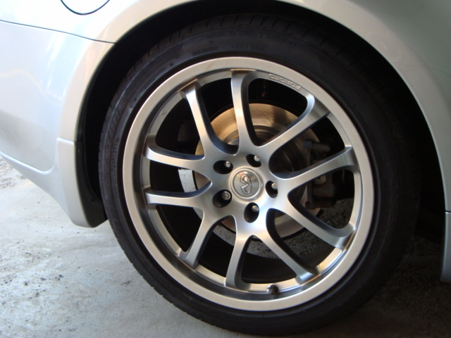

here's how they look now
but they have developed some rust in just a day, I washed/waxed the car today, and found some rust spots on the rotors, hard to clean/reach. Any solution for that??
this is pic of the day i installed them.
