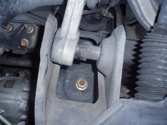

Well I have a 03’ and after many hours of research on numerous shock and suspension web sites (Monroe and Rock Auto parts were 2 of the best) I decided to go with the same year stock 350z kyb fitment, they fit perfectly and after 43k mi. still ride great. Bye the way we have shocks all around no struts, the fronts are just big coilovers, and unless you have a AWD G35x I believe the shock fitment is the same for 03-05 sedans. I’ll be doing my sister 05’ in late October.
Before you start the job be sure to check out your suspension components, especially the bushings in the steering and front suspesion, inner Lower control arm (Generic pic but my LCA bushing looked exactly like this https://g35driver.com/forums/attachm...1&d=1254384492)
and compression arm bushings (just do a site search to see) seem to be the major wear items, I had to replace my lower control arm bushings with a better than stock 350z replacement component from white motor sports, not hard to replace but that bushing as well as most of the other G35 bushings have to be pressed in.
