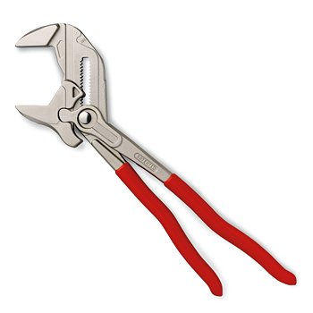

^ I've used this type of wrench/plier before, and compressed each piston one at a time.

okay cool what are there like 2 pistons? wasnt that hard? because im gonna do a rotor and brake change all 4

^ There are two pistons in the front and one in the rear. It isn't all that hard (but I've been changing my own brakes for years now). Just look at the DIY and video above, and it should go pretty smooth.
