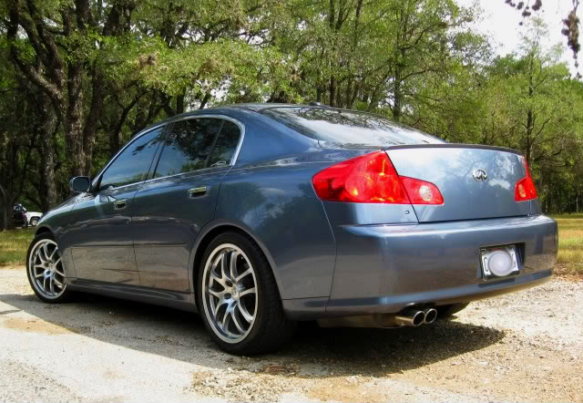

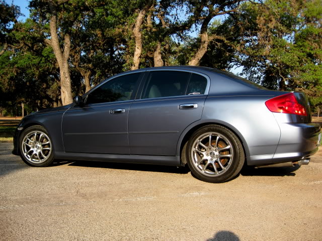

Please don't kid yourself or get me started. Your rims are just fugly, but that's my opinion. If you like them more power to you. If you think I'm nuts, ask the other members here for their opinion.
BTW I have the coupe Rays 19s. Sweet rims on a sedan, you should get some.

I'd take the Rays anyday.

Blue Dream - You're not nuts...you have taste.
