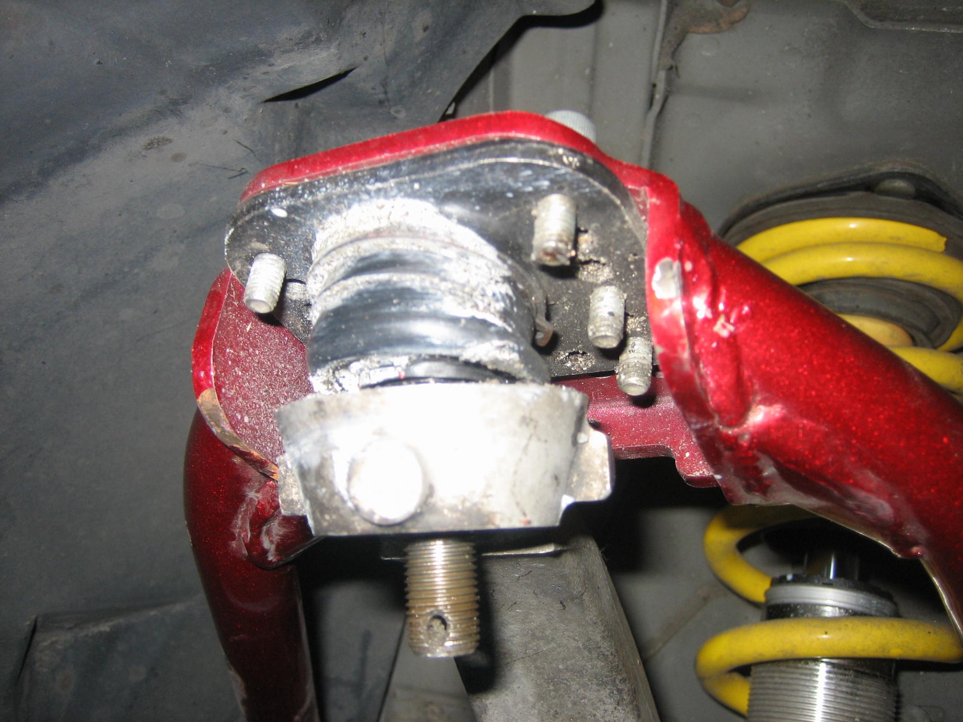

Damn it, I have no luck fixing the problem. I have 2 suspects now, the camber arm and the end link. Both seem functioning okay when I tried to move them thru their entire range of movement. I am attaching the photo of the arm which shows the boot not seated fully. I was able to rotate it(ball joint) 360degress with no problem and also move it in all directions. Did not seem to feel loose or broken- other than the boot. Same thing with the end link,I can point it to all directions and noticed no slop (one end removed from the lower arm). However, when I compared it to the right side, I can't seem to make the right side budge a little- seems like there is not much play when bolted. So I am not sure if you are suppose to be able to move the link sideways while attached/bolted to the lower control arm.
Anyhow, is there anyone else that had this problem that came up with a solution other than what is already mentioned here???
PLS HELP!
PLS HELP!
