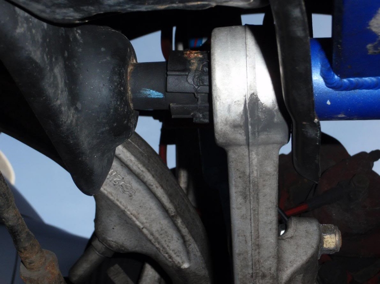

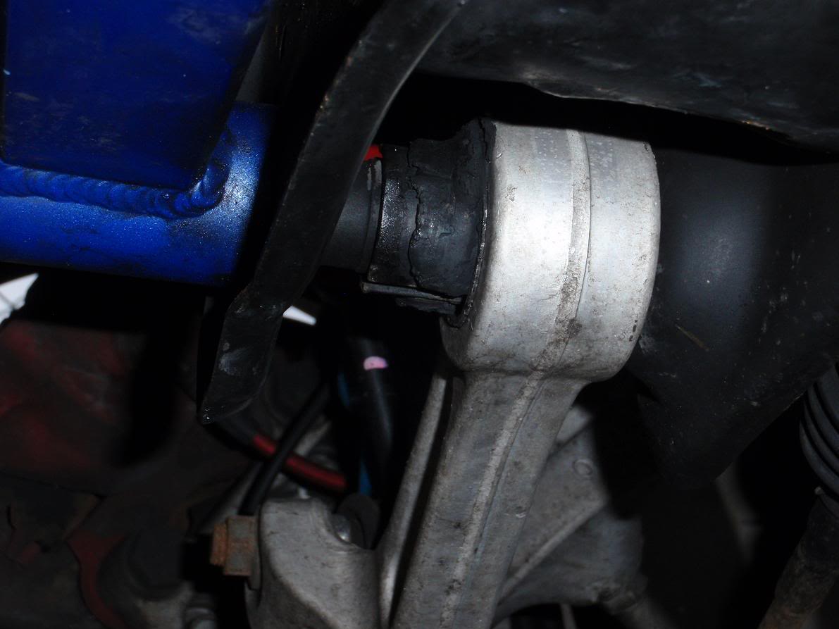

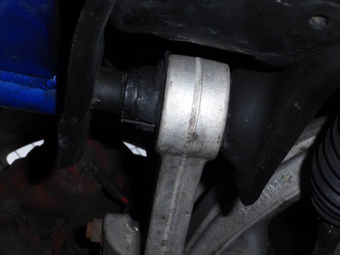

As many of you know, Whiteline just came out with some bushings for our cars. There is a whole set for the rear end of the car (I didnt need these as I already replaced all of mine with the NISMO hard rubber bushings from www.mynismo.com). They also have newly come out with a set for the front control arms which are known to fail. There haven't been a lot of options for replacing these and whitelines polyurethane version are the pefect compromise of performance and comfort.
I hadn't noticed any noises but I was under my car the other day and this is what I saw.

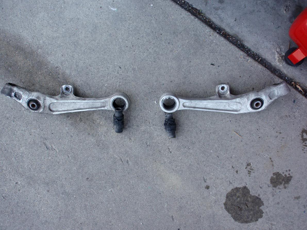

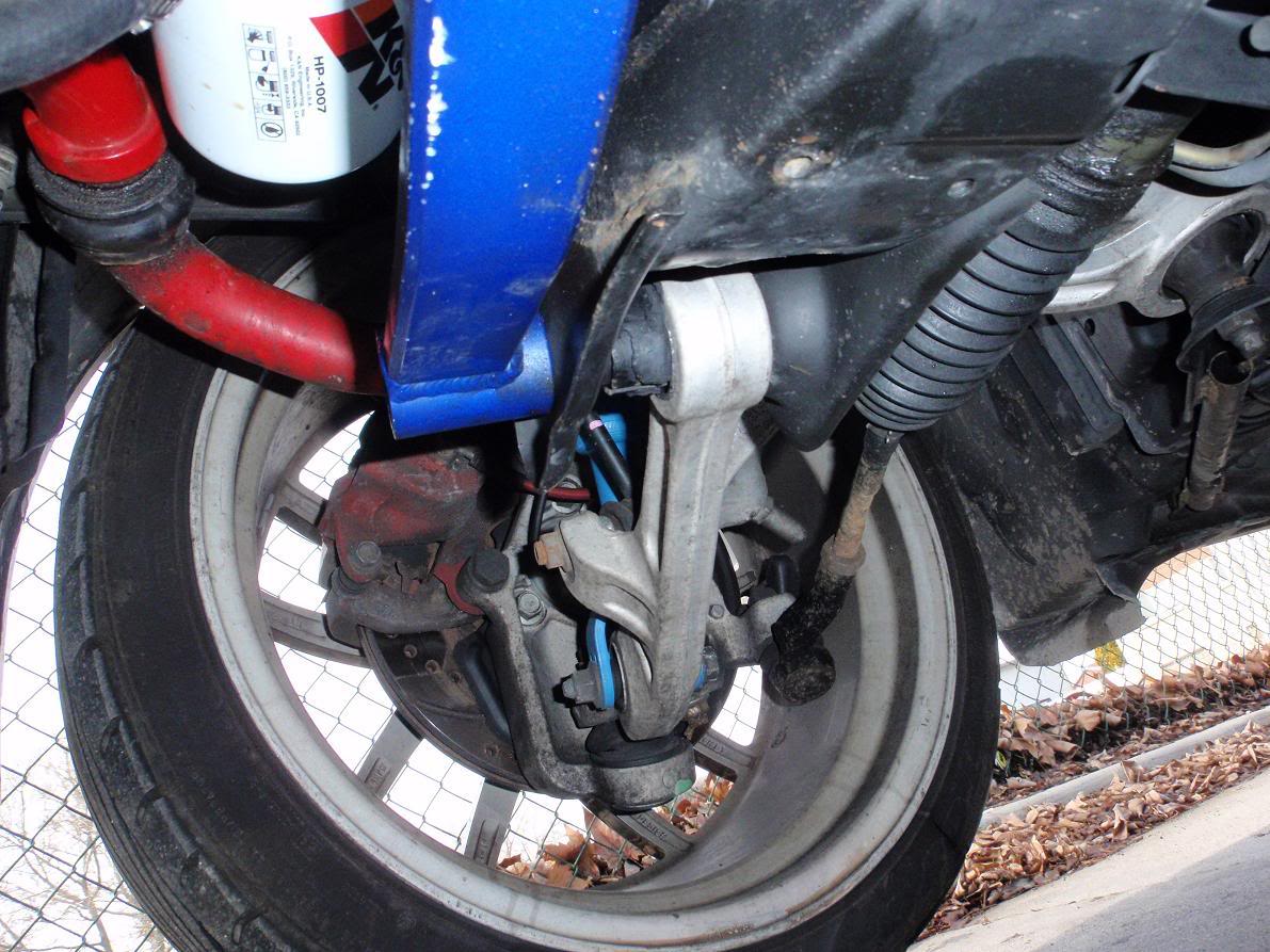

If you are getting noises on your front end in the suspension and are having a tough time diagnosing the location, take a look at your control arm bushings.

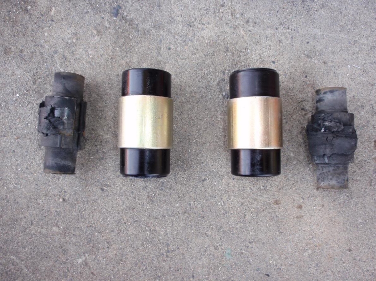

I removed the control arms and this is what is how they look. fatigued and completely worn, they had seperated and were starting to make noises.
Direct comparison of the quality of the bushings. This is the same thing for the strut mount bushings on the control arm as well, with the exception of shorter size.
