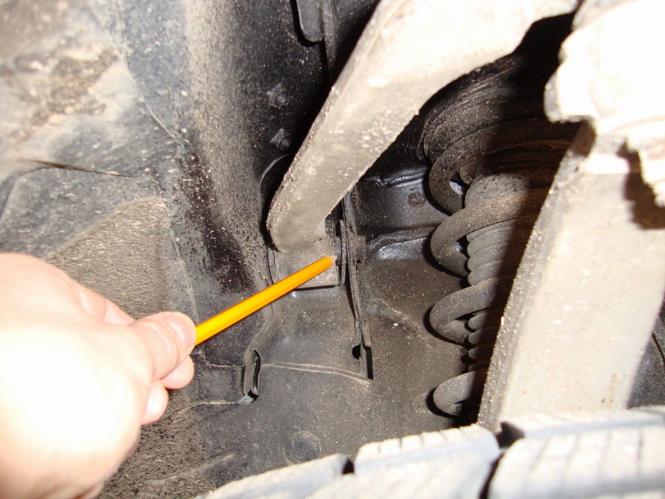

Here is apicture of the washer on the Upper Control Arm. It is clearly loose. I took a quick look at another Infiniti I saw in a parking lot.. it was the same. Are they all loose like this or was his bad too. Upon further inspection nothing major located visually. There seems to be some play (give) in most of the bushings. Upper C/A Inner Bushings, Transverse Link (Lower C/A) Inner Bushing and Compression Rod Inner Bushing.
Compression Rod Bushing- $22.95 @ Riverside Infiniti
Front Upper C/A Bushing - $14.95 @ MyNismo
Lower C/A Inner Bushing - $40.95 @ MyNismo
The compression Rod Bushing is for the AWD X Model
Does anyone know if the Upper/Lower Control Arm Bushings are the same for Sedans and Sedan AWD Models, Coupes?

Are you taking about a rubber washer?...if so, yes mine were both dangling. I'm not sure what the significance of these rubber washers were for since I noticed they weren't wedge in there, nor acted like shims in between. I have no clunking noises.
Check for a metal tapered sleeve at the ball joint. If you bought your G used, it's possible that the previous owner forget to put back the tapered sleeve that was borrowed from the OEM arms to use for their camber kit.
Also, to make certain that you speak of the same clunking noise...does it make the noise at bumps? or does it make the clunk going from reverse to forward?

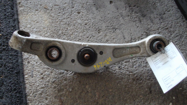

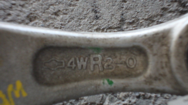

I think the washer is metal. Good call on the sleeve but I don't think it has ever been changed with anything but OEM. Clunking noise appears at real low speeds 5-10 MPH when going over cracks in the road. I purchased a used lower C/A and I am going to swap it out and see if this eliminates the noise. I think it is the lower C/A inner bushing because it has some "give". The bushings for this are on backorder until April so I figure I can swap the C/A out, see if it fixes the problem, and then order the bushings when they get in. I don't even know if the bushings will fit the AWD Model so at least I have an extra arm out of the car for measurements and any bushing fit tests. Anyone know if this is the same part # for Sedans and Coupes?
