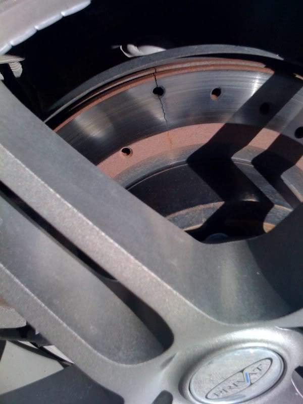

I wish I had bought the slotted rotors instead of drilled.....
Never again.
And yes, these were Centric rotors. They said so on the rotor.
