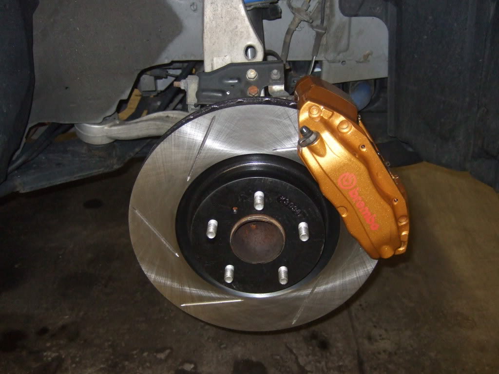

This past weekend I installed new centric slotted rotors (aka PowerSlots) and StopTech Street Performance pads (aka 309 pads) on my OEM-Brembo coupe. Obviously going from original rotors with 73-k miles to new makes a huge difference, but I would have to say the biggest difference after the pressure change is the faster bite the StopTechs have over Hawk HPS. The StopTechs are also more affordable as well.
I've been doing what I could to get a good feel for the whole setup since I installed them, driving like a mad man to and from work and so far I am all grins and popping eyeballs. With the wet weather we have been having here lately it is nice to be stomping on slotted rotors again, there is definitely a huge improvement in wet braking performance compared to the OEM-rotors.
I would surely recommend this setup to anyone looking for added performance, but looking to maintain streetability as well. So far I have not heard a single squeek from the pads and they perform a lot better in emergency or cold braking than the Hawk HPS do. Too soon to comment on dusting vs OEM vs HPS, I'll update as use continues.
