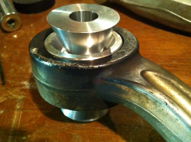

I fixed the broken bolt. Well its a band aid fix but it seems to be holding together great. I took some pictures at the time of repair. My father-in-law really helped out a lot. Hes a machinist and had a lot of tools for the job.
We first had to remove the bad compression rods. This too was a nightmare. We had to Burn off the rubber bushing. Then cut, twist and bent the metal part of the bushing to get it off. This metal piece seems to weld itself to the large sub frame stud with rust and corrosion. Because this part seems to go bad every year I decided to replace the stock bushing with a an all metal replacement. I have added pictures of these new bushing installed.
After getting the metal sleeve off we had to drill a hole up the middle of the sub frame stud. We went about 3 inches up possibly more. We then used a Tap and die to tap threads into the hole. I then took a long bold and threaded it into the hole. I then cut the head of the bolt off and reinstalled the compression rods. Put everything back together and put a nut on the end of new bolt.
Its been holding well for several months. Summer and winter conditions.

Wow, that's pretty crazy. You must have tightened that nut real good last time you replaced your arms, and eventually got rusted, making the nut impossible to remove. These bolts are class 12.9 and are an integrated part of the body; they have much higher torsion and shear strength than the bolts that hold your shocks in place. They are not meant to be replaced because they should withstand even the impact of a collission.
I saw it happen on a 240sx subframe bolt. The guy basically had to buy a new chassis and swap everything out to fix the problem. It's very important to keep these parts clean and free from rust.

Yeah man, I defiantly would not buy the stock compression rods ever again. These SPL bushings are the way to go. If you can return your new rods you bought I suggest you do it. Get the SPLs. The stock bushings are JUNK!
