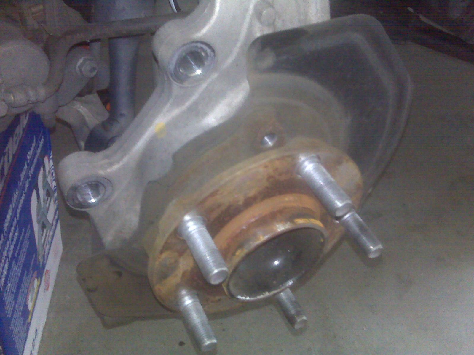

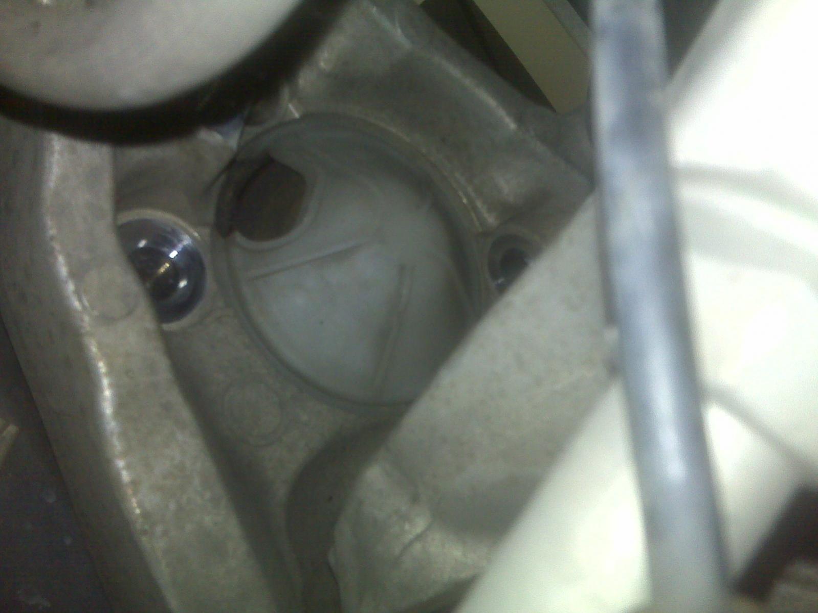

I need help removing the front hub. I have removed the four bolts on the back of the hub. Now the hub won't come off. Is it because of rust? I tried using the mallot and it still won't come off. Is there another bolt somewhere that I'm missing?
Attached Thumbnails HELP with removing front hub-img00412.jpg   HELP with removing front hub-img00413.jpg

just the 4 bolts in the back, make sure u take the speed sensor out on the side too. and air chisel is what i normally use to get between the hub and the knuckle.......if you dont have that, get a big screwdriver or get a big chisel and hammer away between to get them to separate. sometimes just hammer on the backside of the hub itself (the portion with the studs) and itll come forward.........

Well after an hour of fighting it and hammering the crap out of it from behind, it came out.

yeah they are in there pretty good. thats why air tools are so much better lol. make sure you clean the surfaces up with sandpaper or something too as you can see whatever dirt/rust/oxidization on the bearing and knuckle before puttin it back together
