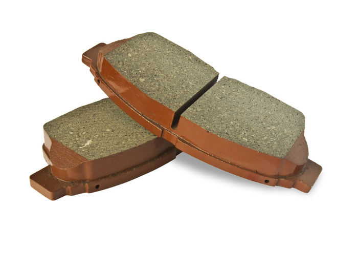

im having the exact same scenario with my g. Did your pads come with the corners ground down?
my mechanic buddy said performance pads don't have this (to keep more surface area)
this causes brake dust buildup bc the dust has nowhere to go, and thus squelage.
I have yet to grind mine down im waiting for spring so I dont know if this is it for sure. I may be wrong
Attached Thumbnails Brembos sqeauling with new pads and rotors-4697brake_pads.jpg

no the tech grinded down the corners which made them squeal a little less but the sound is still ear piercing
