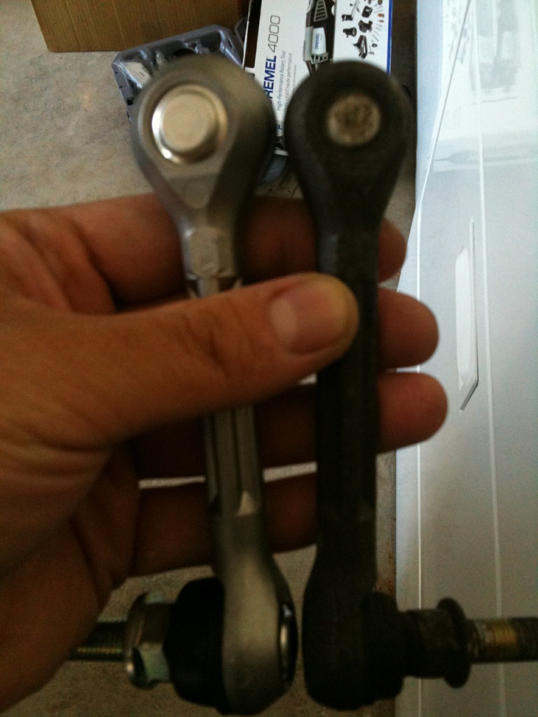

Endlinks my guess. If you have an 04 or older the endlinks were pretty weak. Long story short I had the same creak over every uneven surface. I am dropped on Tein springs. I swapped for OEM enklinks and I have zero sound coming from the rear now

Cool... a few things to make note of... Mine sound only came from the rear right... and then it started on the rear left. The endlinks looked good... couldn't replicate the sound with my hand by yanking on anything underneath.
Aftermarket endlinks are a grip, like about 165 for adjustable ones. I just bought two oem ones because it was about 38 bucks and the first set lasted 60k miles. Just sayin'... money to be spent elsewhere. Here is a pic to compare the old and new ones... notice the new ones are beefier. hope this helps

Oh yeah you can definitely tell the difference. I don't have 165 dollars for adjustable ones right now, might have to go with revised OEM ones (05-06). Thanks for the pics.
