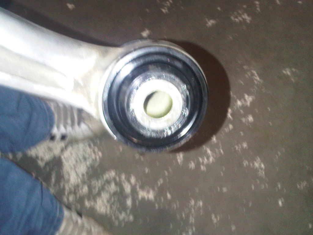

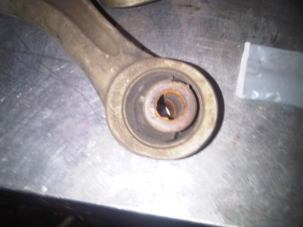

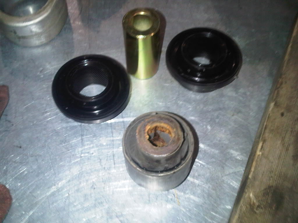

OEM bushing

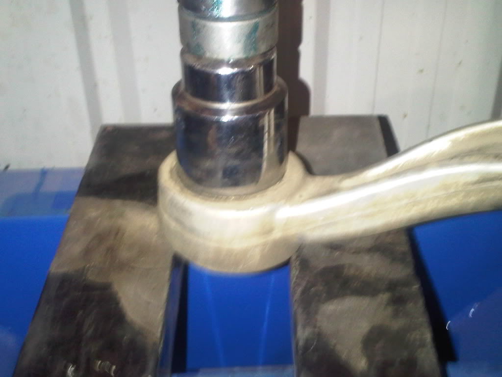

Pressing it out

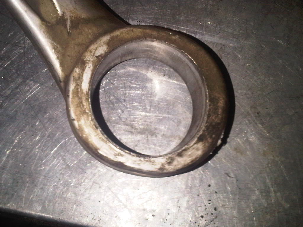

OEM out

OEM vs Whiteline compression rod bushing
Whiteline compression rod bushing in

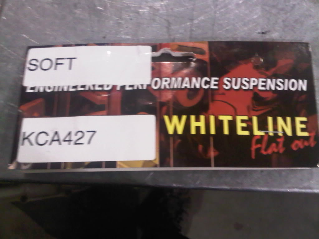

Part number for the SOFT ones i guess i should have taken pictures or got the # for the HARD ones pictures were an after thought. this will help though the hardest part of the whole thing was getting Whiteline on the same page as to which bushings we were talking about. As far as I know G35/350Z owners are the only ones that call them Compression rods most will call them radius rods.

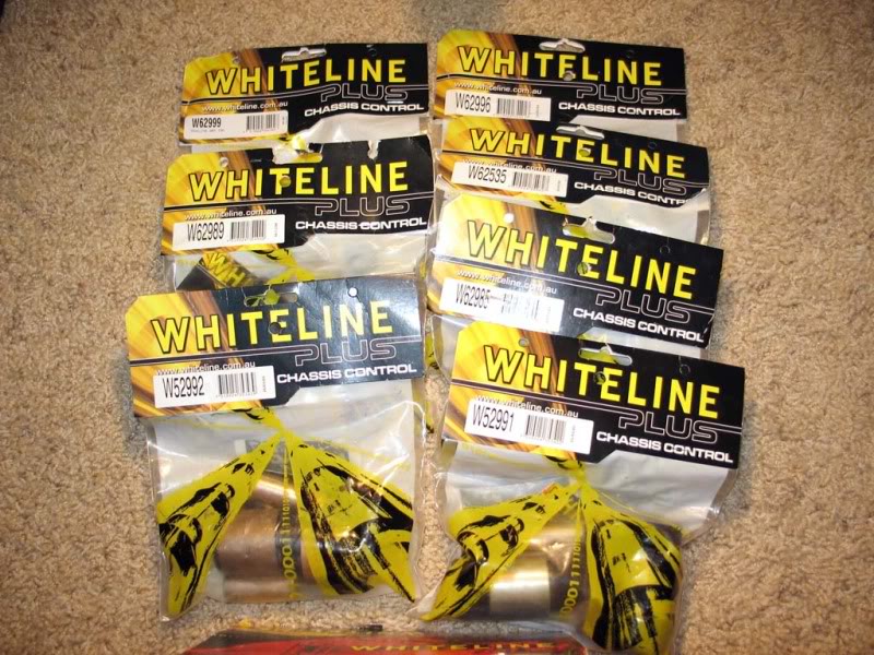

I replaced mine as well last year and since I was at it I replaced the shock absorber one and the one on the other side of the compression arm. I'd be lying if I said my car handles better but at least the metal to metal noise is gone and seeing the state of my old bushing this replacement gives me a piece of mind. Interesting that you had a choice in durometer for it, I only had one choice and I'm not sure if it is hard or soft.
Just checked my photo album and noticed that your part numbers are completely different then mine.
