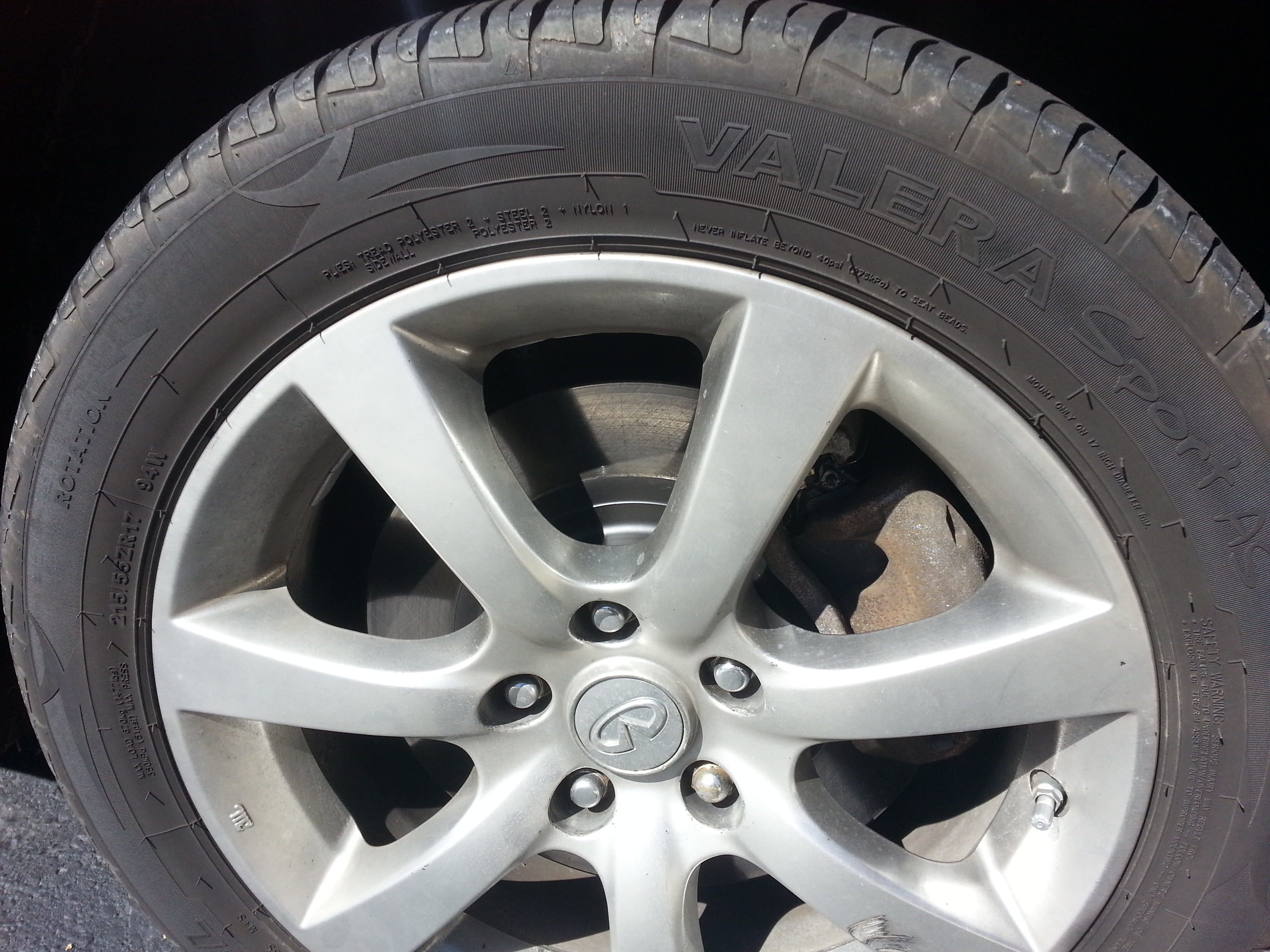

Non-slotted/drilled installed @ 90,000 miles, with Akebono ceramic pads, specifically resulting from this thread.
Maybe I'll repost in a few years with progress/status, if I change them again at any point.
The black painted hat is really all I want to last over the years, hate the red rust ring look.
