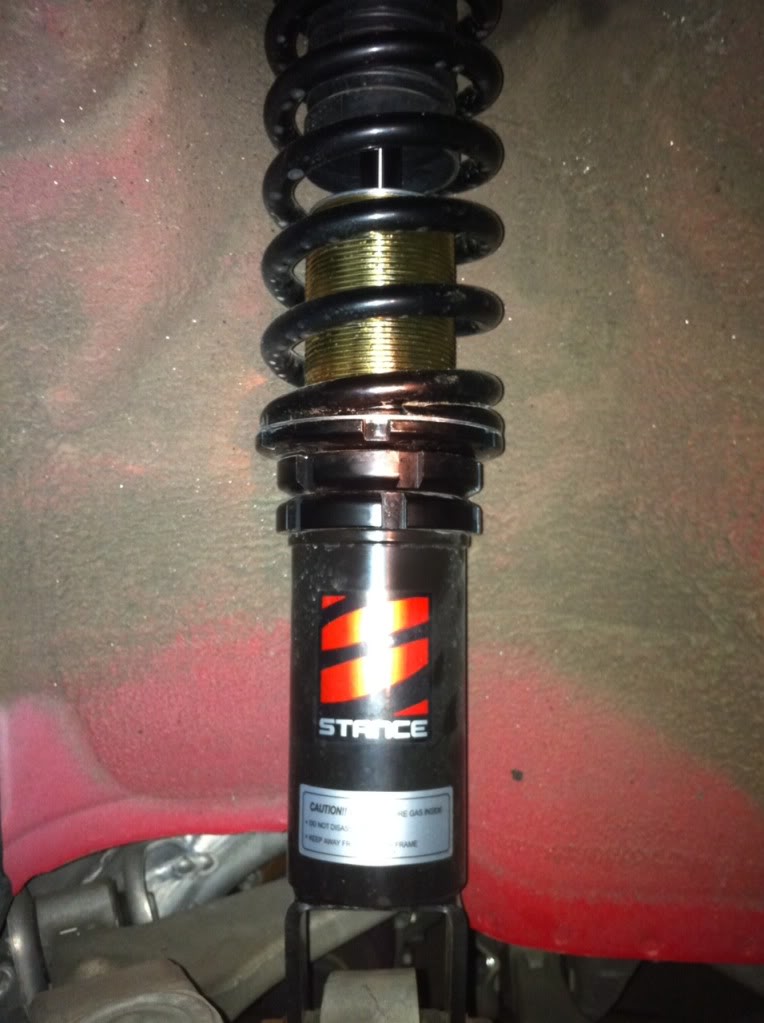

But heres what happens when i mAx it out there is about an inch gap between the lower lock nut and the upper lock nut. Dont have pics but i notice in other peoples threads the rear coils are maxxed out and the lock rings are touchig eachother which is the reason why people can remove collars. But on mines my collars dont touch eachother when i maxx it out.
these are someone elses coils that are maxxed out. they say that you can remove the lock ring in the middle but thats the part im talking about where that middle lock ring has an inch space to the lower locking collar.
