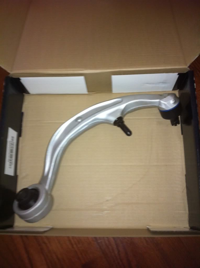

Old Nov 15, 2012 | 02:52 PM
StreetChase's Avatar
Joined: Aug 2006
Posts: 995
From: Jersey/Towson, MD
This just showed up today, ridiculously fast shipping. I just ordered it yesterday morning lol
I am going to be putting the OEM suspension back on and swapping out this LCA on Wednesday so hopefully that puts this issue to bed, fingers crossed!
