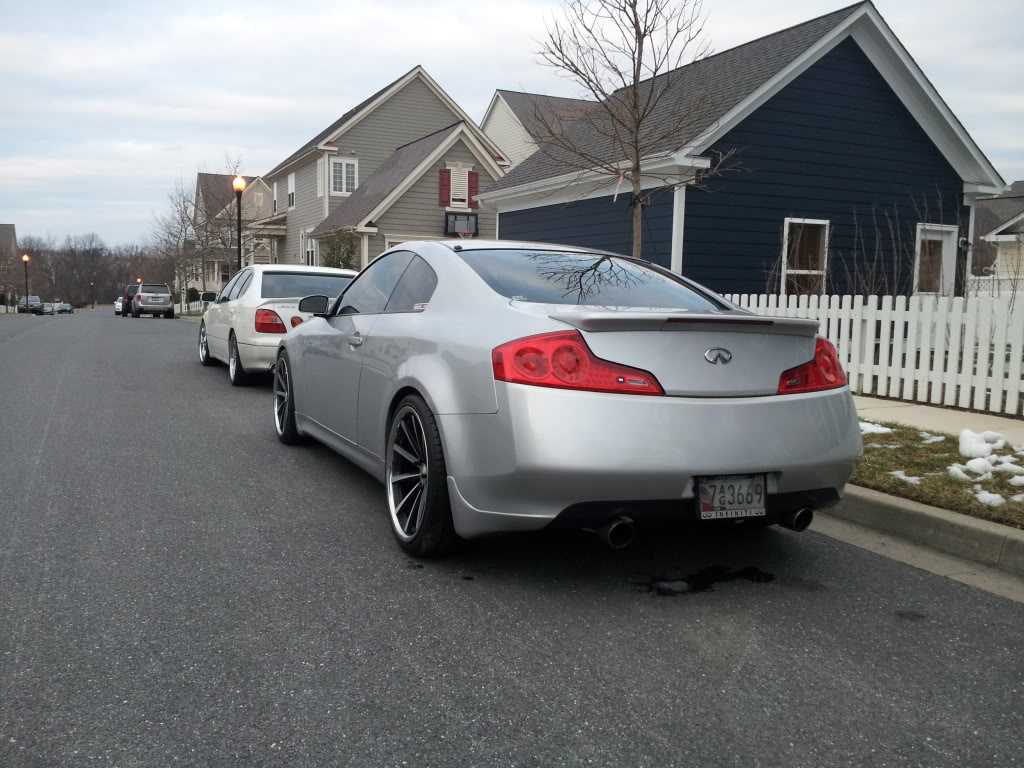

Originally Posted by ivey_usmc
I have a 05 g coupe with 20 in vossen wheels. 20x9 in fornt and 20x10.5 in the rear. If I go with the 350z springs and shocks will I rub or have any fitment issues?
Depends on your offsets. I'm on CV1's 20x10.5 +22 rear with a mild 3/4" drop on revised Z springs, and I rubbed and needed to roll the rear.
That offset puts the rim right at flush in the rear, if you're running weak +42 offsets, you'll probably be fine though.
For the sake of picture whoring...
Here's the rear after a roll:
How my car sits:
