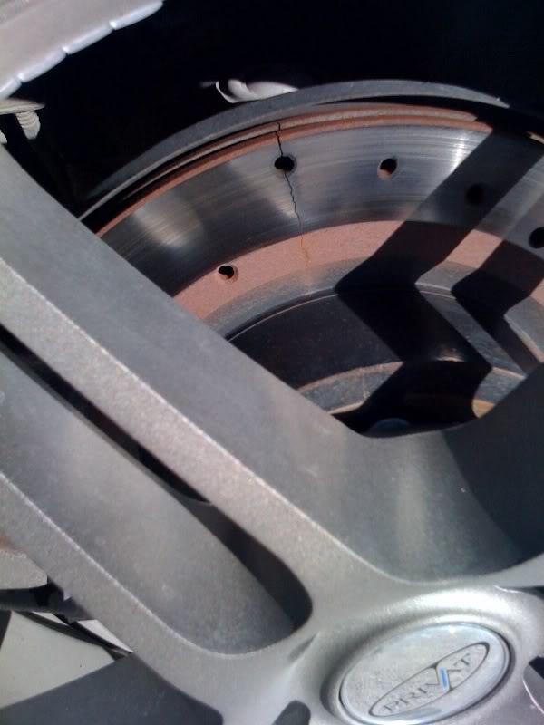

Due to aloss of integrity, drilled rotors may crack under hard braking. The holes help disperse heat to keep the rotors cool, but slotted rstors can help cool as well but their main function is to expel carbon from more aggressive brake pad compounds to help keep the brake pads contacting the rotors when you need them to. Unless you are braking so hard that your rotors are always turning red, slotted rotors can be much more functional while looking nice too.

Don't by StopTech drilled rotors.
I tried Hawk HPS and they scared me to death in cold wet weather.
EBC "green stuff" grabbed like crazy, but ate rotors like candy.
Went back to a ceramic stock pad.
