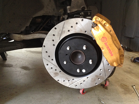

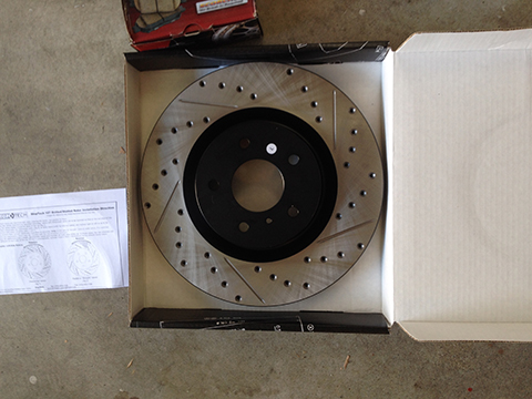

Old Feb 13, 2014 | 08:49 PM
MacTwidget's Avatar
Joined: Dec 2013
Posts: 2
04 Coupe w/Brembos
The local Infiniti dealer quoted me $1200 to replace my front rotors and pads.
OEM Brembo rotors are crap. It's their calipers that they are known for.
I went to RockAuto.com and got StopTech (Centric) drilled/slotted and StopTech pads for around $250.00 including shipping. So far I am VERY happy.
Question: What do I need to replace rotors?-img_1016.jpg
