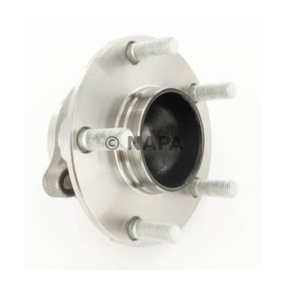

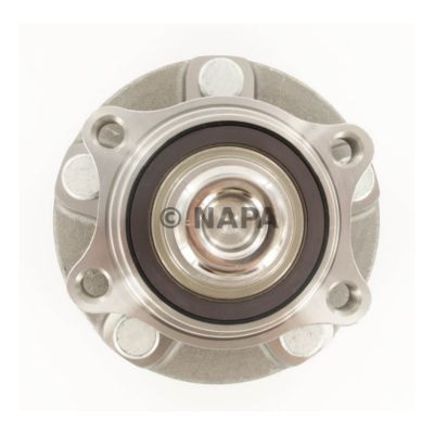

Hi,
Just received new wheel bearing and hub assembly for front 2004 G35X and I'm not sure how to install them.
The center where the axle goes is sealed. I thought I got the wrong part but I checked the website and the pictures match what I received.
I uploaded the pics. Do they need to be prepped somehow ?
Thanx for your help.
To Moderator : Sorry for posting in general thread.
Attached Thumbnails Question about new front wheel bearing and hub assembly-wheelhub1.jpg   Question about new front wheel bearing and hub assembly-wheelhub2.jpg   Question about new front wheel bearing and hub assembly-wheelhub3.jpg

They look like RWD front hubs.

You got the wrong part.
Part number for X front hubs are: 40202-24U00
There should be a hole for the front axle to go thru.

I was about to say these are not for driven front wheels.

Thanks guys. I confirmed that yesterday. So far, three places I've been to all sell the rwd version for the X awd as if they are interchangeable and when I checked the NAPA part and saw the pic was the same closed middle I was all over it. Bearing and hub $84 shipped?!?! I was all over THAT, never realizing it was just too good to be true.
