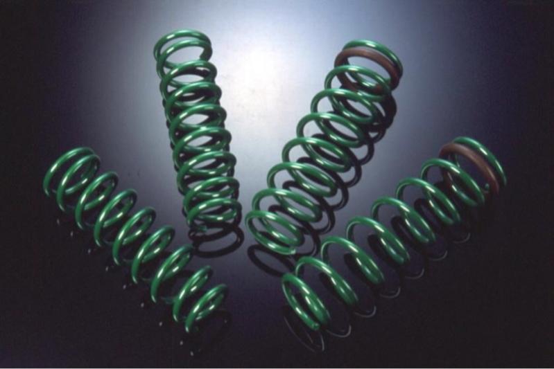

Post your lowering spring or coilover setup and the alignment suspension parts you paired with them (if applicable).
Include brand names, prices (not shipped), and if you have springs, the amount of drop. Looking to compare setups and prices. Example of the setup Im thinking about getting:
Tein S-tech $172 F: -1.2, R: -0.9
Kinetix Front Camber arms $245
SPC Toe bolts $25
Attached Thumbnails Post Your Spring/Coilover + Alignment setup-image-2690901250.jpg   Post Your Spring/Coilover + Alignment setup-image-139545653.jpg

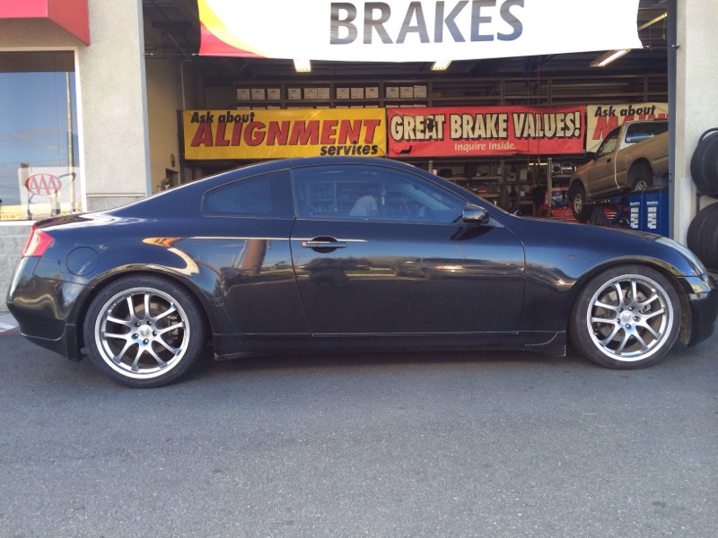

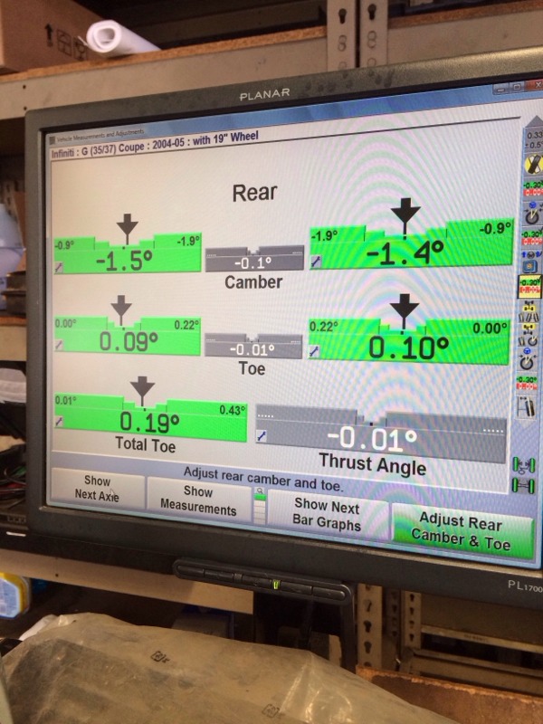

Here I am on swift springs with rear spring mount mod. 1"/1.1" with spc rear camber and toe kit. Front camber arms will come depending how the front tires wear. 20mm H&R spacers on the rear, 15mm to come for the front.
Post Your Spring/Coilover + Alignment setup-6efcpkp.jpg
Post Your Spring/Coilover + Alignment setup-rzy2rop.jpg
Post Your Spring/Coilover + Alignment setup-ssewtkb.jpg
Post Your Spring/Coilover + Alignment setup-awpwldh.jpg

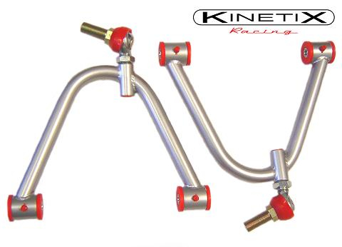

You say cheaper brands don't, how bout kinetix front arms? This is from the product description on their website:
These arms will allow 1.5 degrees of positive camber, and 1.5 degrees of negative camber from the factory settings. So if your car is lowered 1.5" and the front camber is sitting at 2 degrees negative camber, these arms will allow you to bring them back out to .5 degrees negative camber.

This is what I'm looking at buying. From eBay
Brand New
Kinetix Racing
Front Upper A-Arms w/ Camber Adjustment
Applications: Please see compatibility link above.
2003-2006 350Z / G35 (All Trims and Models)
2007 G35 Coupe only (All Trims and Models)
2003-2008 FX35 (All Trims and Models)
Complete upper control arm replacement allowing positive and negative camber adjustment of the front wheels. These arms will allow you to either add positive camber to your wheels (EXTEND tire life) or to add negative camber (increase handling). OUR ARMS OFFER THE MOST POSITIVE ADJUST-ABILITY OF ANY ARM ON THE MARKET (longer tire life!) The front suspension from the factory allows zero camber adjust-ability which can become a problem especially when lowering your car. Race enthusiasts also wish to add more negative camber to increase their handling without having to "slam" their car to achieve the desired camber. These arms will allow 1.5 degrees of positive camber, and 1.5 degrees of negative camber from the factory settings. So if your car is lowered 1.5" and the front camber is sitting at 2 degrees negative camber, these arms will allow you to bring them back out to .5 degrees negative camber.
These arms are completely TIG welded and offer a huge upgrade in strength over the factory arms. They use ENERGY SUSPENSION polyurethane bushings for increased responsiveness over the factory rubber bushings. They also use a high quality 3-piece Heim ball joint protected by a polyurethane red dust boot. These Heim joints offer the best in suspension responsiveness and smooth operation. These Heim joints are also highly serviceable and do not require any special tools to remove. The have Teflon coatings inside for "chatter" free operation for years. We have also included grease fittings for even easier serviceability.

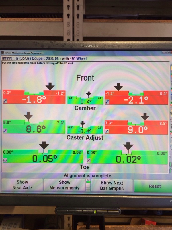

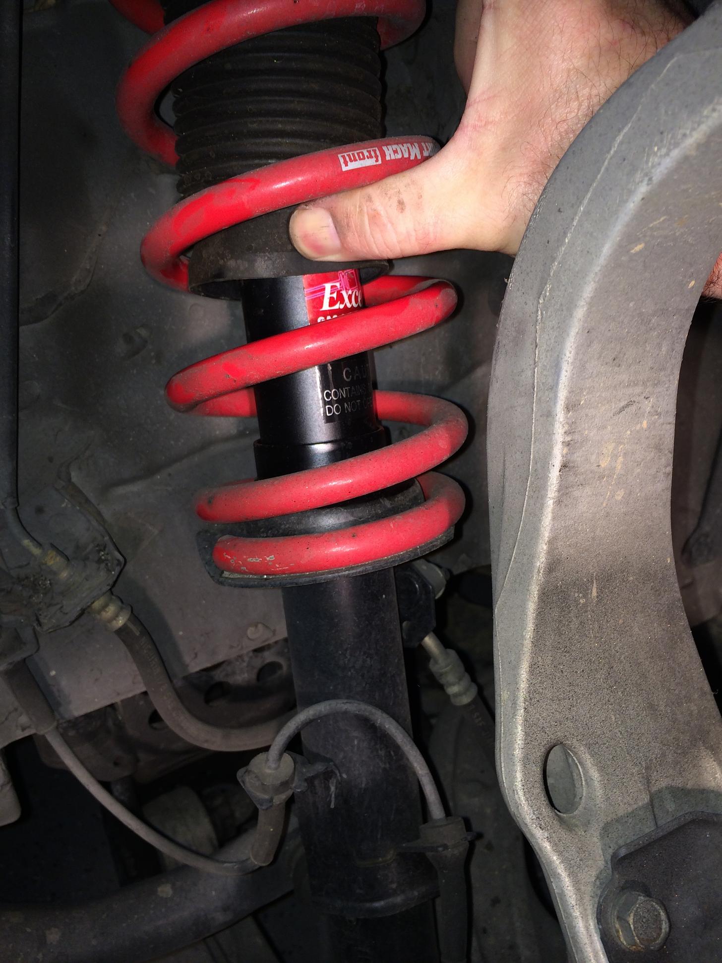

Swift Sport (red) springs with rear spring mount mod
KYB excell G Shocks
Spc Rear Camber arms with Toe bolts
Camber: -3 front -1.2 rear
Looks good but deff looking into getting Stance Super Sport coils pretty soon along with the SPL front camber arms.
