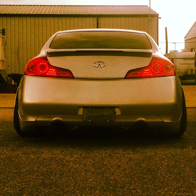

Hey guys,
06 g35. running BC OEM style coil overs, have them at the hardest setting and I'm riding at about 25 1/4' from ground to fender. Fenders are rolled flush with a pull. Wheels are 19X12 +7 with 255/35-19 in the rear. I am kind of new at the stance game, so I need a little help with the spring rates. Also running some decent camber already, I'm guessing around -5 ish. but I can't find a shop that can get it on an alignment rack.
If i hit a bad pot hole (that I can't avoid or don't see) the tire is hitting the fender and pushing it inward causing the tire to rub. So I have to pull it out again later.
Is there a spring rate that anyone is running that they would suggest? I tried searching and didn't seem to find an answer or didn't understand the explanation.
Thanks in advance.
