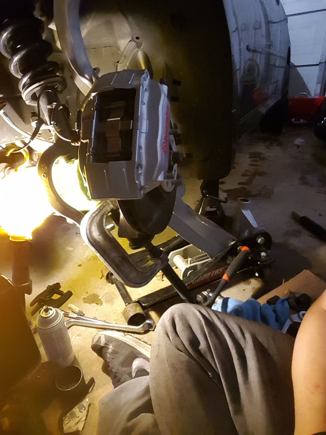

Those MAS 61035 balljoints do not fit at all!! The problem being is that the cone seat that comes pressed on with the MAS balljoint won't fit through the hole of the lower control arm. You must use the OEM balljoint cone seat for any balljoint to fit. But the OEM cone seat does not even fit on to the MAS 61035 either. I removed the cone seat that came with the MAS balljoint and put the OEM cone seat on and it wouldn't slide down flush. Ask me how I know. I wasted money buying these garbage balljoints.
I ended up buying the Duralast BJL148 balljoints from Autozone at $50 a pop. I was surprised to find out these are the same exact balljoints used by Infiniti because of the name and numbers printed on the base of the balljoint housing. Even though you can't buy these balljoints directly from Infiniti. Even says Made in Japan on the packaging. Then repackaged by Duralast. The OEM cone seat fit directly on to the Duralast balljoints.
I pressed it in on the car by the way. No need to remove the whole steering knuckle:

I'd also like to add some tips before you think about doing this yourself. It will save you time and headaches.
1. Besides the balljoint press to put in the new balljoint, I recommended buying or renting a balljoint seperator to pull off the OEM cone seat.
2. To have enough room and for obvious reasons, the lower control arm has to be removed. You will need a balljoint separator to pop off the bottom of the endlink from the lower control arm.
3. I recommend having and air or electric impact to do this. It makes quick work of it. A simple ratchet or breaker bar will suffice, but expect some swearing and broken knuckles along the way!

Use this to remove seized cone seats:
These are made specifically for things like that. No cone seat is fully seized to the balljoint stud. Just got to use the right tools to get the job done. You can rent these for free from Advanced Auto parts or Autozone. What it does it use tons of force by grabbing the cone seat and pulling it away from the stud. Works every single time I used it. You could probably save the hassle and buy new cone seats from Infiniti, but you NEED this balljoint separator to do other parts of the suspension anyways. It can also be used to pop out the balljoint studs from their sockets for things like endlinks, upper control arms, compression rods, etc.
Duralast balljoint comes with new cone seats, but didn't look like OEM for some reason. I just threw my old cone seats back on.
