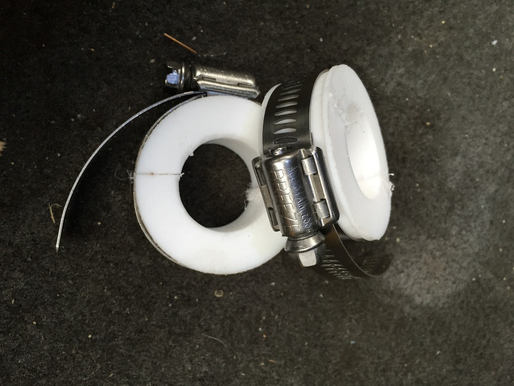

None of it installed, but I have a pair I made for the opposite side, just in case. That bushing seemed fine but i'm going to install these anyway.

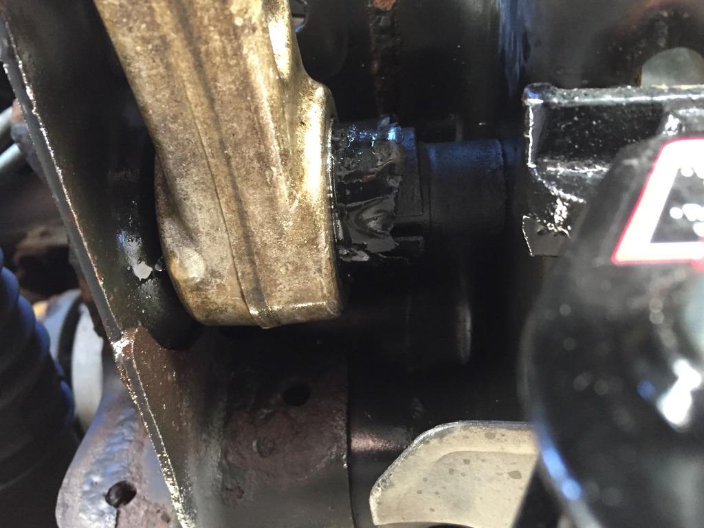

First, the torn bushing. As you can see I soaked the area in PB blaster for the upcoming disassembly. I'll keep soaking it until then.

And what I made. I just put one on each side. Just a temp repair to keep the arm centered so I don't chew up my tires any more.
