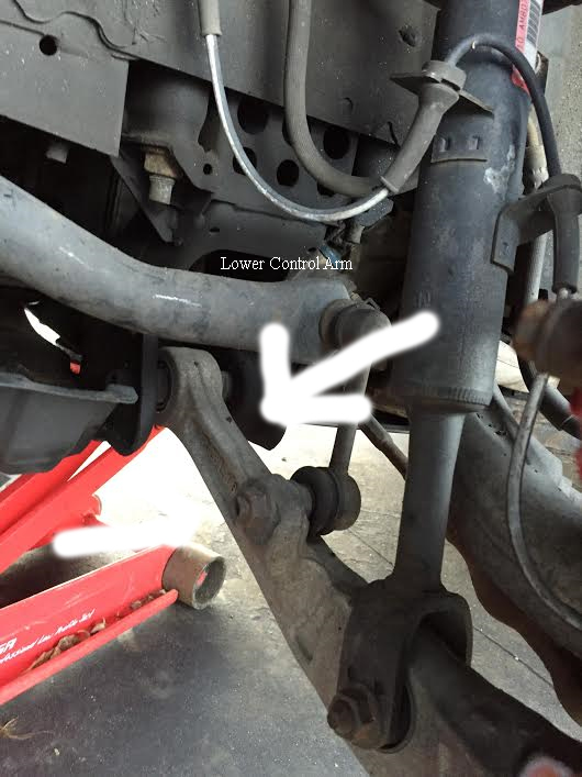

Question for you guys who are the pros. I am doing shocks and struts on the 04 coupe (94k miles). It takes bumps harder then I care so I think they should be done, from what I read 94k miles they should be done anyway. I am just going with the KYB since I don't track and I probably would never adjust the adjustable anyway.
With 94k on the car, (this car only gets about 7k miles a year) what else would you do? I see talk about the lower control arms, RockAuto has Dormans for $52 https://www.rockauto.com/catalog/mor...id=383&jpid=31 with the ball joints. Is this necessary?
Anything I am missing? or should I not even bother with the control arms and just do the struts/ shocks and of course the strut/ shock mount kits?

I would go ahead and replace the lower control arm along with upper control arms as well; what youre showing is the compression rod (not a bad idea to replace either). The upper control arms are pretty easy to do so you can maybe take alittle longer with those if the ball joint is still in good shape (doubt it after 95k). You could also just replace the balljoints and bushings alone as well on all, but i wouldnt recommend it on the upper control arms since they are pressed in weird and the only way to take them off is a saw apparently. If the arms come with the ball joint its a plus!
Is replacing ALL the arms or bushings necessary right now? No. Would it make your car ride like a brand new car again? Yes.
If you're planning on taking this to a shop to do, it wont be cheap to replace all these arms. Its really not super hard to DIY, just get a buddy and some long ratchets to break the nuts.

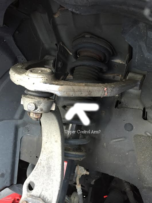

1) Is it true to check the control arms with the car up on jacks if you put your hands at 9 and 3 and wiggle the wheel you should see movement in the wheel if the control arm/ joints are worn out? I checked both the wheels and there was no movement at all. Once I moved the wheel enough the other moved right along with it mimicking it. That means the control arms are still in good shape and don't need replacement at this point?
2) I checked the tie rods as well since I had everything apart as well. I couldn't find any looseness/ movement at all. So they should be good still as well?
I am thinking I might just do shocks and struts but don't want to skimp, if it needs control arms, minus well do them but if they are still good, I figure I will do them down the road if/ when they wear out.
3) Also, can I ask what is in the third picture titled "what-is-this. Does that eventually wear out as well?

First pic is the front upper control arm (has two bushings hinging from the car), second - lower control arm (it has a inner bushing and a outter bushing for the strut), third - compression rod (you can either buy the whole arm or like i said press out the bushing).
You can press the bushings out yourself and replace them. if you have a press its way easier. Just not recommended for the upper control arm for reasons mentioned above.
i dont know of any specific ways of diagnosing the arms, generally if theyre torn/cracked theyre bad. At 95K, its probably getting close to being torn/worn anyway.
