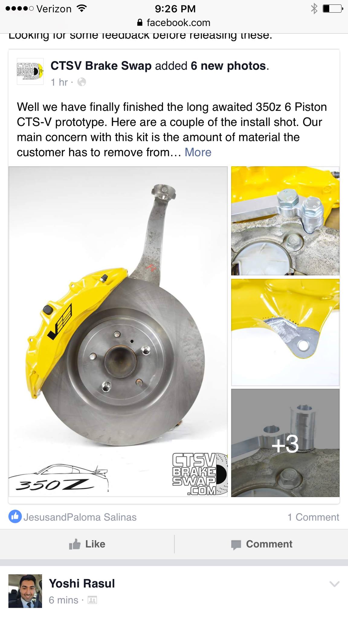

Originally Posted by LOLmustangLOL
I wonder if STI/EVOx/Genesis Brembo's can be retrofitted onto our cars... Hmmmmm
How about CTS-V BBK's? Someone just made adapters for the 350z/G35. Only bad thing is in order to fit the bracket you would need to remove a substantial amount of material from the steering knuckle. These would look sweet tho
Facebook Page is "CTSV Brake Swap" in case any of yall are interested in reading more about it, also the maker is asking for feedback before sending these into production.

Old Mar 25, 2016 | 12:55 AM
  #18
.cakestar's Avatar
Posts: 1,786
Likes: 178
From: Seattle
damn. thats even more material getting shaved off than the 17z swap
if only you didn't need to shave the material off the knuckle ;'( I would've done this already lol...
there HAS to be an alternative! I really like the EvoX or Genesis Brembo's? They may be 4/2 pot but they look nice and beefy compared to ours.
Has anyone looked into it??
