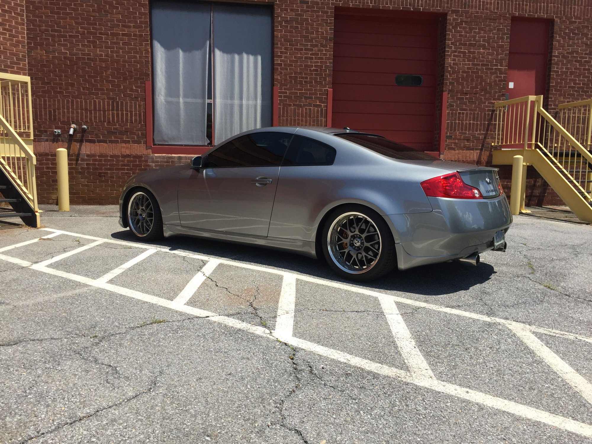

Finally had my Fortune Auto 500 coilovers installed and even more finally, just now getting around to posting impressions.

1) To be honest, I think the suggested 10k/8k Swifts and matched valving are too soft! I feel like their set up is geared towards looks while keeping the ride very compliant. I didn't want compliant, I wanted rails! I got compliant.....
2) Now, I "could" buy new springs and sell my old ones...I would go at least 12k/10k if not 13k/11k....I could revolve the shocks....seriously, it's a great marketing promotion, but how realistic is it to rip out your shocks and send them back....
3) Would be nice to have dampening and rebound adjust!
So, to summarize, the Fortunes are beautiful and quality and smooth and robust! But,I think they are too soft all around. Maybe some day I'll swap to 12k/10k,

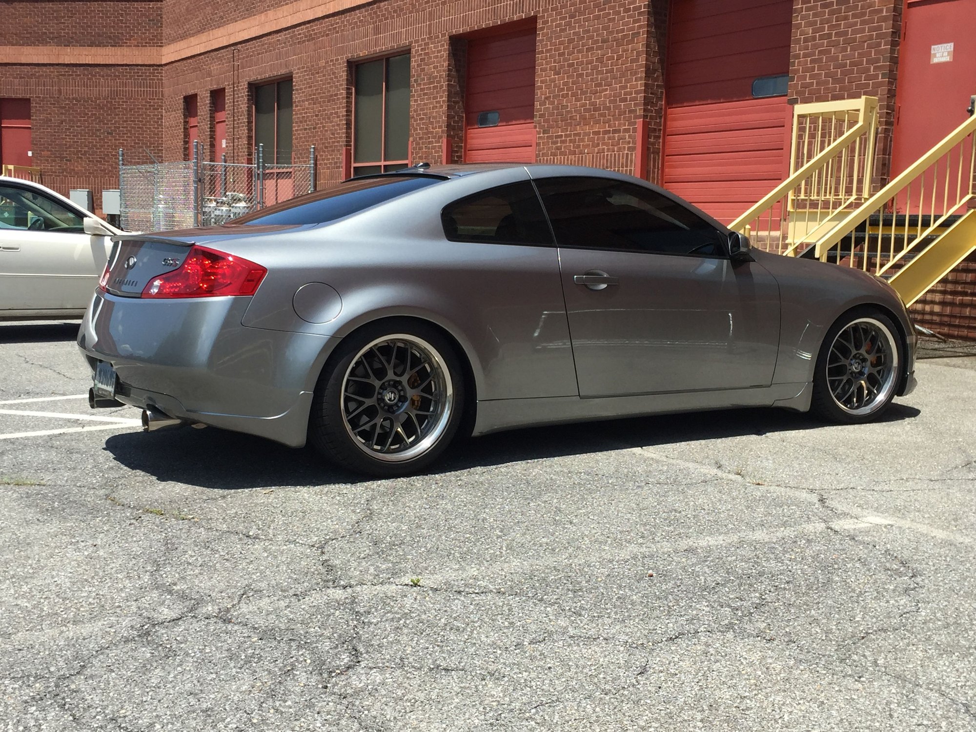

Also, I've never really seen springs settle before, but the Swifts did seem to settle a bit. We had to raise the car 0.5" afterwards to get back to where we started. Fortune suggested that the Swifts perform like softer springs....maybe they could've told me that beforehand!!
