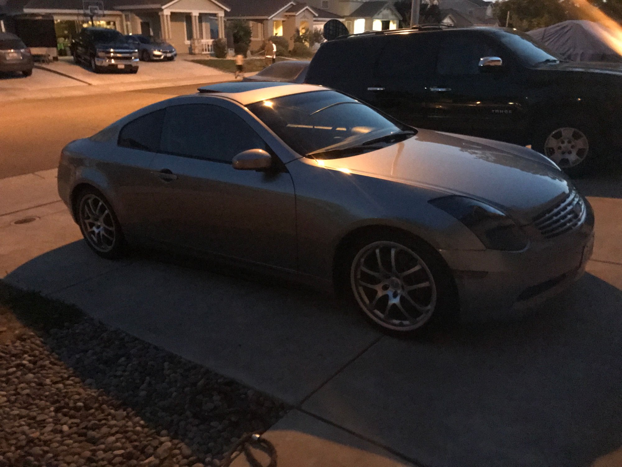

Hello, my g35 coupe is stock height I'm thinking of lowering it about 1" inch or 1" and a half. I'm on a budget and wanted some suggestions.

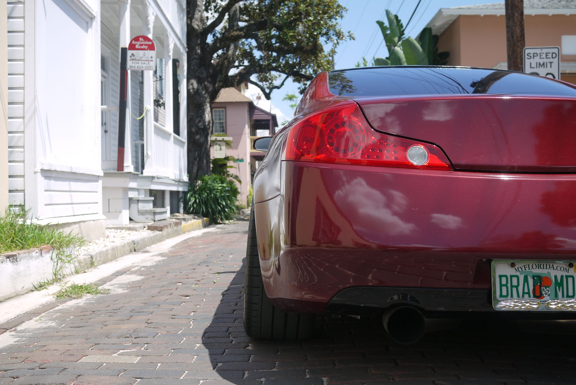

Also depends if you actually do much mileage and your driving style, but I wouldn't say you "need" adjustable arms.
I have -2.5 ish camber in front and about -3 ish in the rear, natural from the drop on Tein s tech springs, on stock arms. The tires I run - Pirelli Pzero front/Michelin PSS rear - are pretty soft compared to most and even with some hard driving, cornering and launches I have at least 2/3rd tread depth remaining after about 10,000 miles. The fronts don't actually show any signs of camber wear but the rears show a little. The inner most groove is around 5mm and the outer most is about 6mm. As said above, make sure the toe is in check as bad toe can eat the edges of tires in under a thousand miles.
