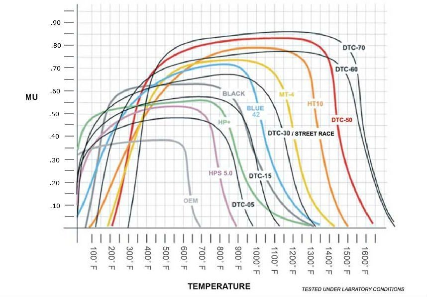

I use the stock 2006 calipers, with cheap R1 rotors (the cheap ones not the expensive ones) Hawk HP+ for street (about the loudest I would want for the street) and now I use DTC-50 for track use, no fade WHATSOEVER and excellent consistent brakes no matter how hot you get them.
HOWEVER! those DTC-50 are some serious rotor-eating track pads so I definitely do NOT recommend them for street use.
The Brembo's are great, don't get me wrong. But unless this is a dedicated TRACK CAR you really don't need them, they look fantastic and have a larger sweep area and thus can get by with a less aggressive pad which = cheaper for budget racing TYPICALLY since you won't be destroying rotors quite as frequently as track pads on a slightly smaller diameter rotor with less consistent grip like a slide-pin caliper from the 2006 year but these things really only come into play on aggressive track use. I compensate with a super aggressive pad and expect to wear out rotors quicker, but I'm fine with replacing my rotors more frequently, I think I paid exactly $245 for all 4 rotors from R1 last time, I use drilled/slotted even though they're "technically" not as good as a slotted-only.
As for Akebono vs. Brembo... from a performance standpoint I don't think it will matter either way unless we're talking some serious autoX abuse and even then I don't think there would be a measurable gain from either setup since pads (EDIT: and racing brake fluid) is everything.
Here's a nifty Hawk comparison chart so you can pick the correct pads for your abuse/use level, most other manufacturers offer some kind of temperature graph like this so do some research and decide how much you're willing to sacrifice for noise/dust.'
