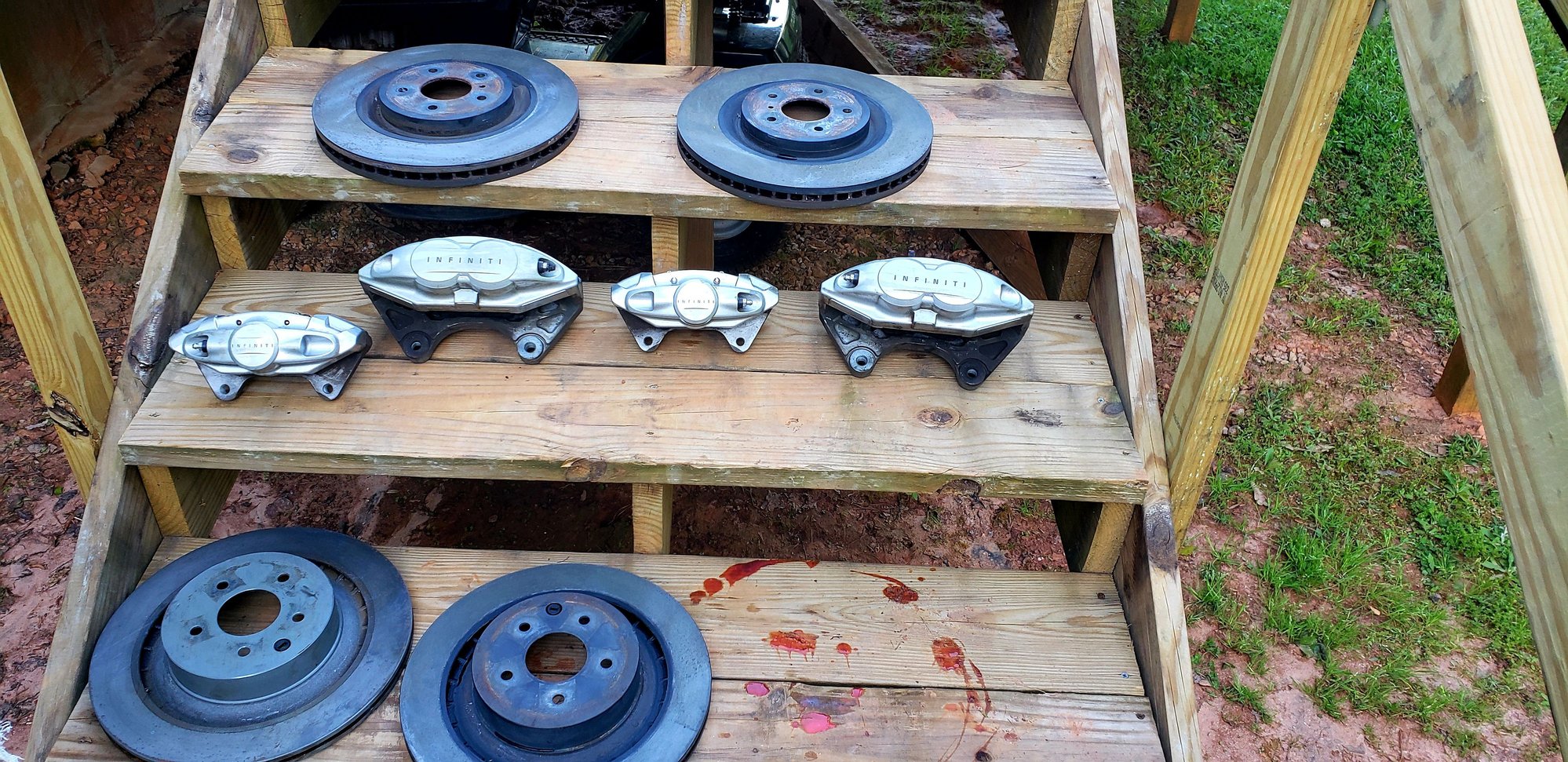

Haha thanks man I've been looking for few months but just got serious about searching for a good price. He texted back today and told me price I told him I'll be there tomorrow to get them. By the pic the rotors are a little rusty but the car has been sitting so I'll have them turned if I dont like the finish I'll get new rotors but I cant complain too much cause the price. I called z1 today to see if they have the bracket for the front calipers they said it's like 98 dollars so I'll swing threw there and pick that up to prob this week as well so I'll have everything to mount them whenever I decide. There's some decent deals on ebay right now too

Went and picked them up today boys, akebono calipers off a g37s with rotors, took rotors to orielys to get them to mic them to see if they can be turned and rotors have never been turned so I'll be doing that with new steel braided lines next month, of course I have to pay 98 dollars for z1 mounting bracket for the fronts to fit but hey couldn't beat the price of 250 😁😁😁

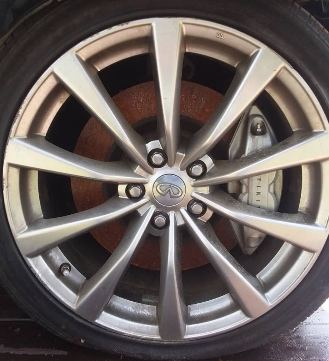

I think that blue would look nice and "ricey" would be painting your stock calipers so they stand out lol. You can pretty much paint the Akebonos any color and they still wouldn't be considered "Rice".
*Random pic I found on Google*
