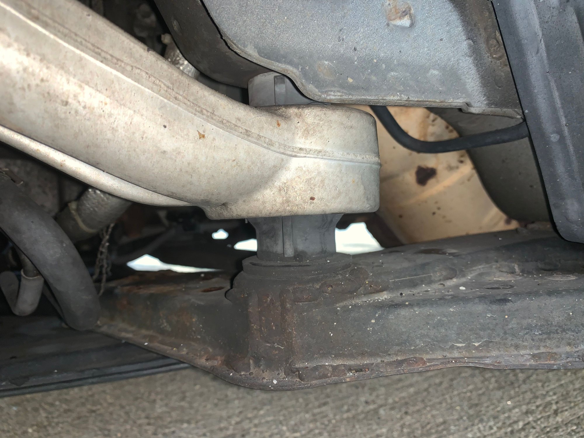

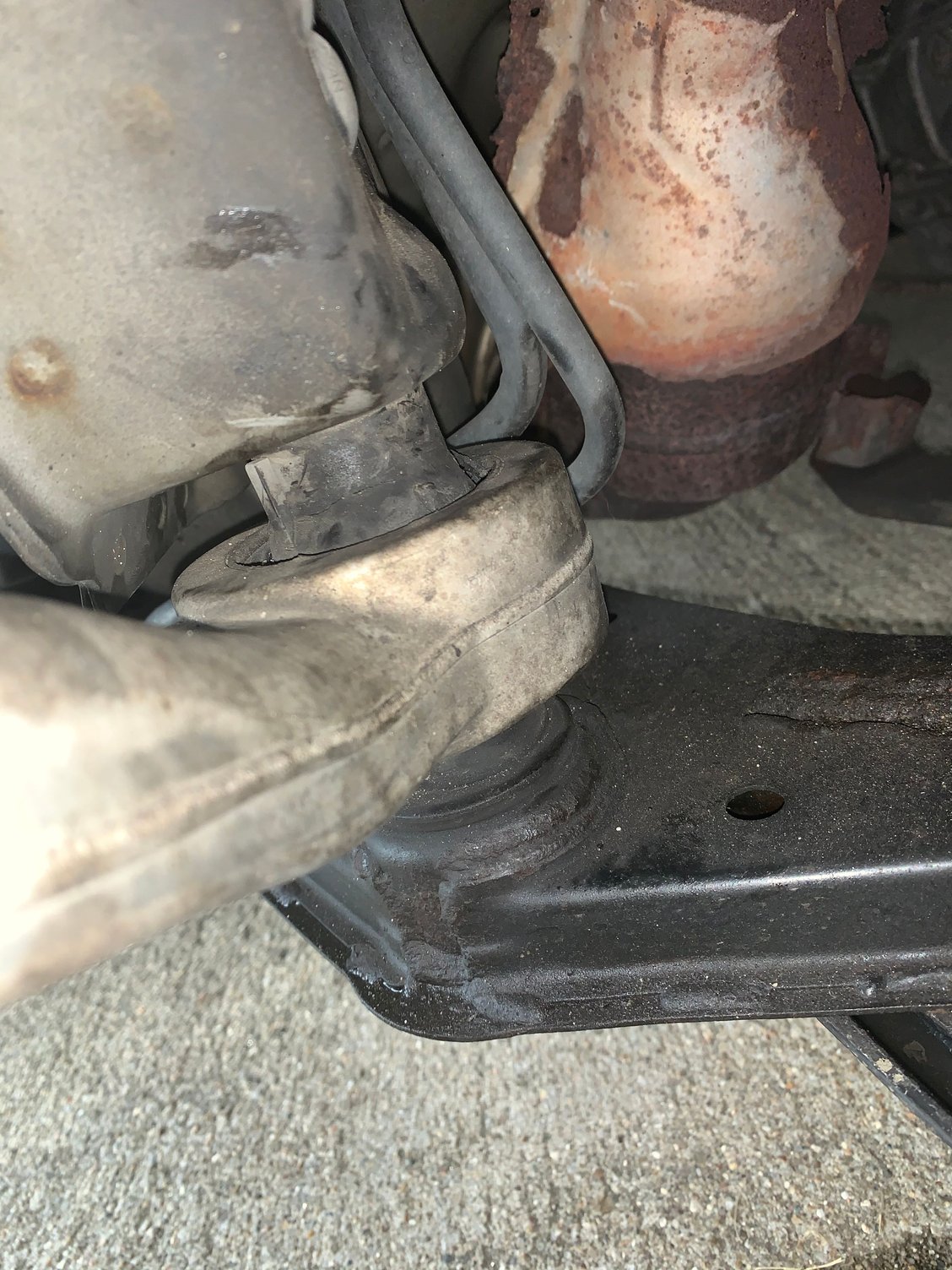

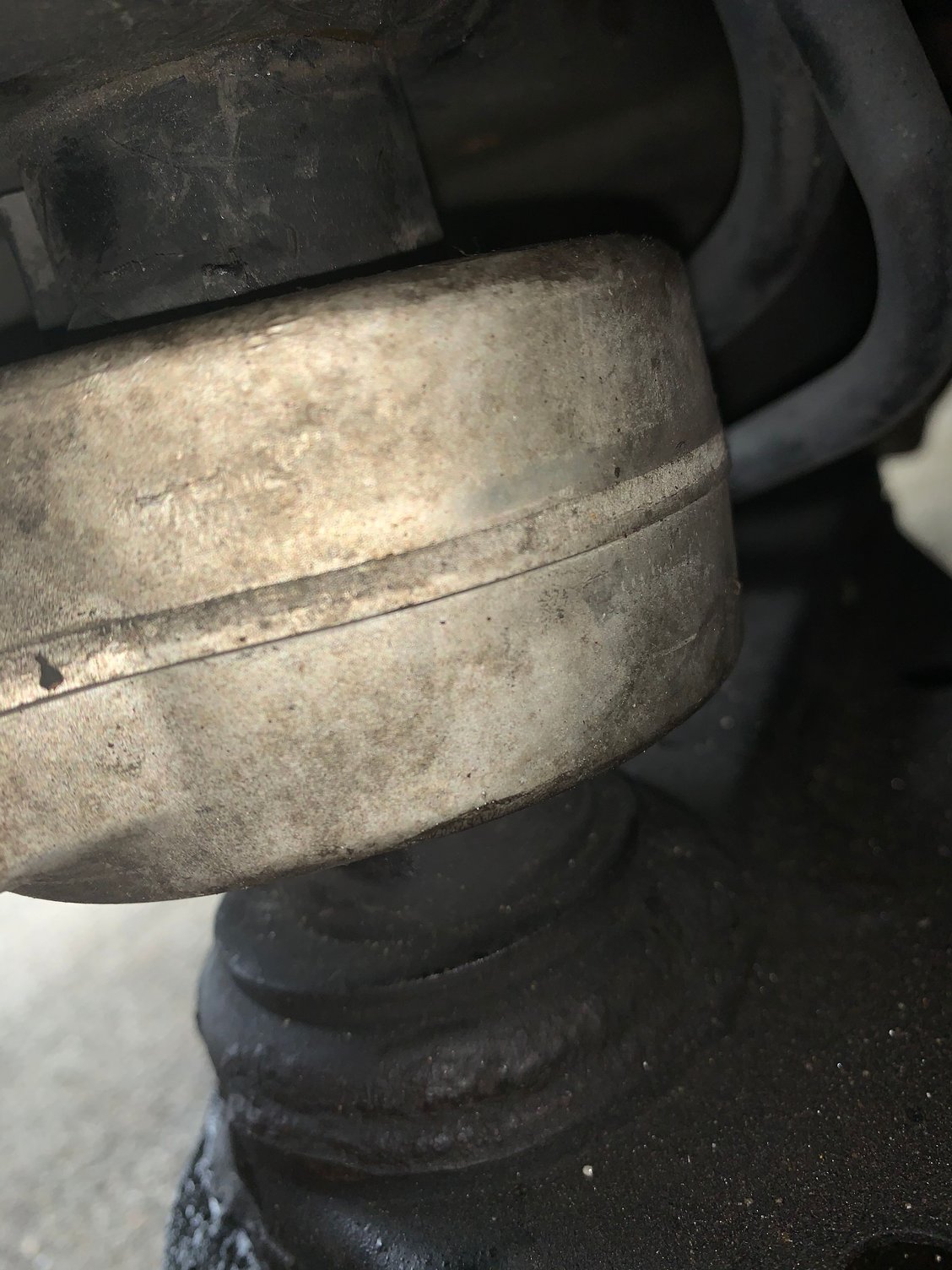

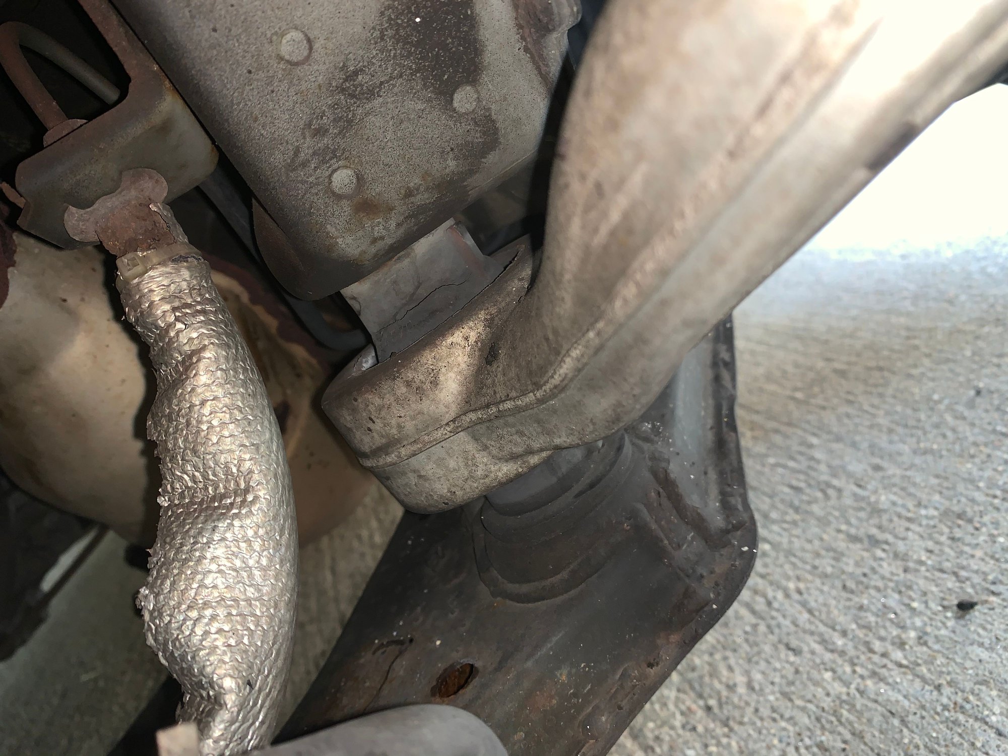

Hey guys, so I believe I have a failing compression arm on my passenger side. Two months ago I got my lower control arm and upper ball joint replaced at a shop because honestly I didn’t even want to bother with it as I had just installed coilovers about a month prior. (i’m sure the lowering from the coilovers is why i’m in the position i’m in) After that repair I was still hearing a noise so I took it back to the mechanic telling them I was still hearing a noise from the front passenger side. They gave it a look and called me back saying there was nothing wrong up there so I asked them to take a drive to hear the noise and was told that it was my drivers side sway bar link. I was already aware that I needed to get a new end link but it still didn’t make any sense to me because the noise wasn’t coming from the drivers side. Last night on my way home from work I decided I would do a little slide on a turn I cane up to and as soon as I straightened out from that slide I heard a noise that sounded like someone banging on a door from the front passenger side and it also felt as if that side of the car was bouncing a bit and since I was so close to home I limped it back the rest of the way and gave it a look when I got gone and it appears the compression rod has failed and i’m hoping that I could get some confirmation that that is my issue and if it appears not to be, get some guidance as to what my issue may be. I will provide some photos, the first two photos being the passenger side and the second two being the drivers side for comparison. Thank you in advance
EDIT: My G is an 04 Coupe 6MT with 142k miles

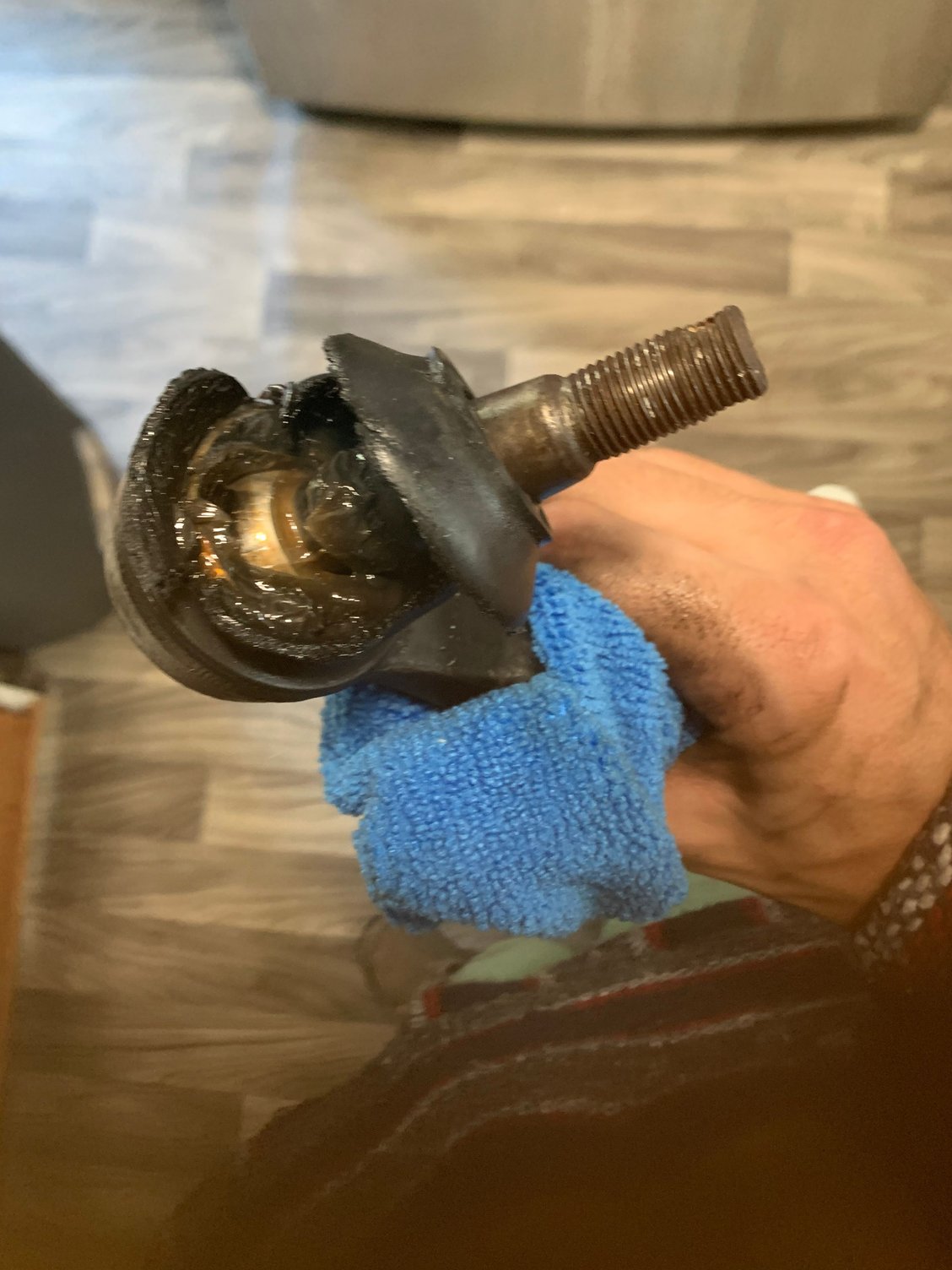

Second Edit: After taking another look, I’m almost positive my issue is in my outer tie rod, I discovered that the ball joint on the end of it is busted.

It looks alright to me.

Its hard to tell from that angle since we can't see the bushings. Are your lower ball joints ok?

Yes it is virtually brand new, but i’m 99% sure i’ve found my culprit, my outer tie rod. I’m currently waiting on a new one to come in the mail today but here’s what it looked like
