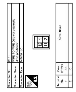

First thing I would test is for power at the seat harness, it's the same harness on both seats so you can unplug both and verify that pin 1 (SB - sky blue) has 12v and pin 2 (B - black) has ground.
Test both seat harnesses so you can compare them.
