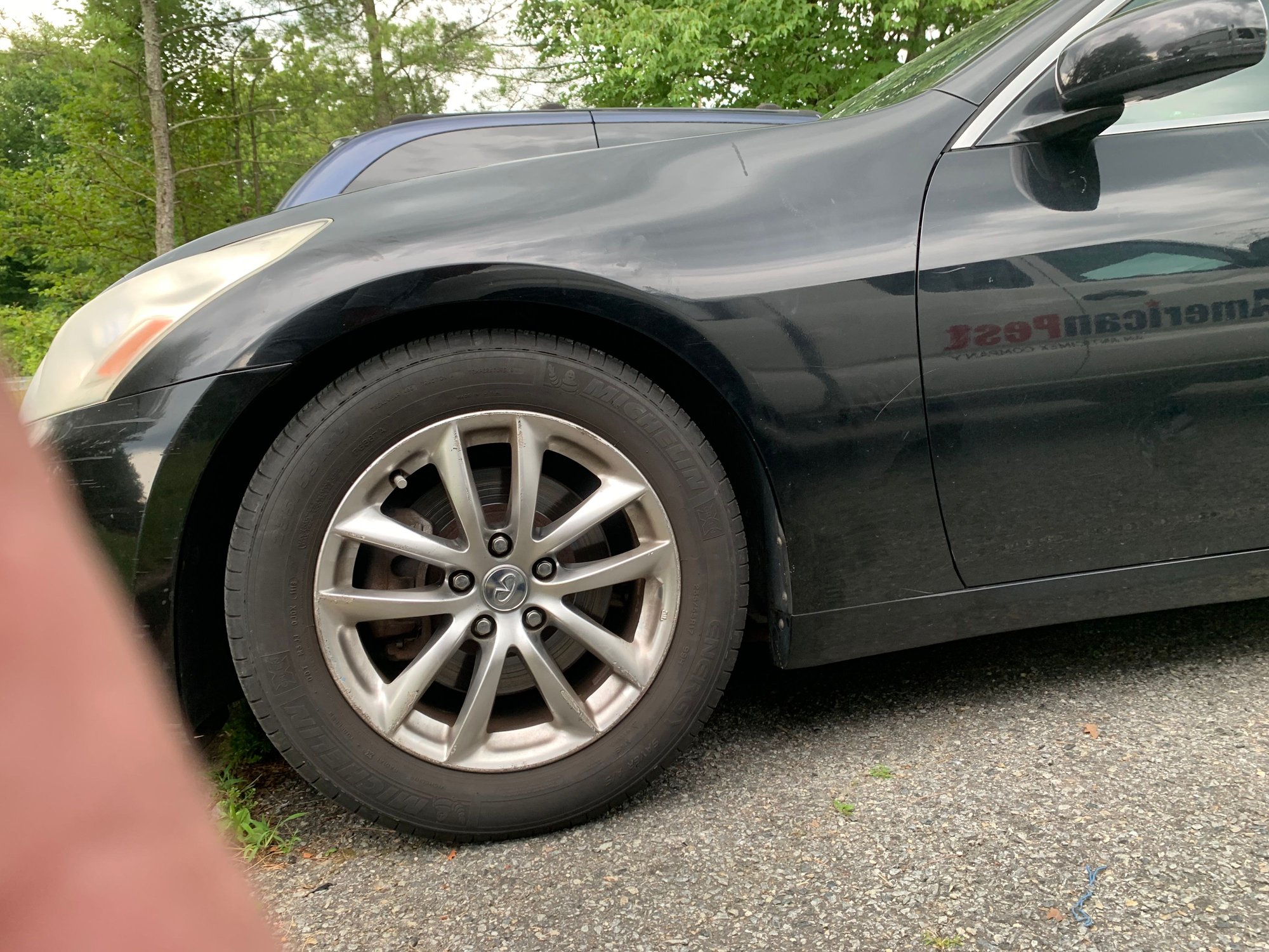

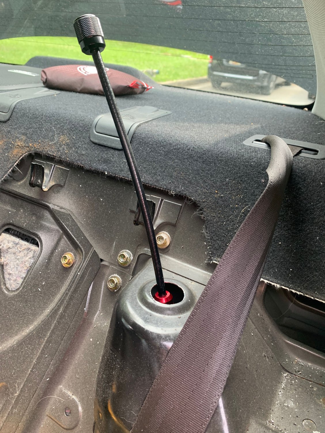

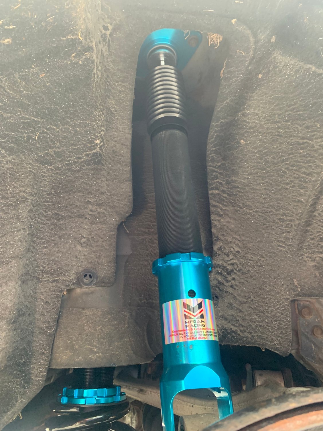

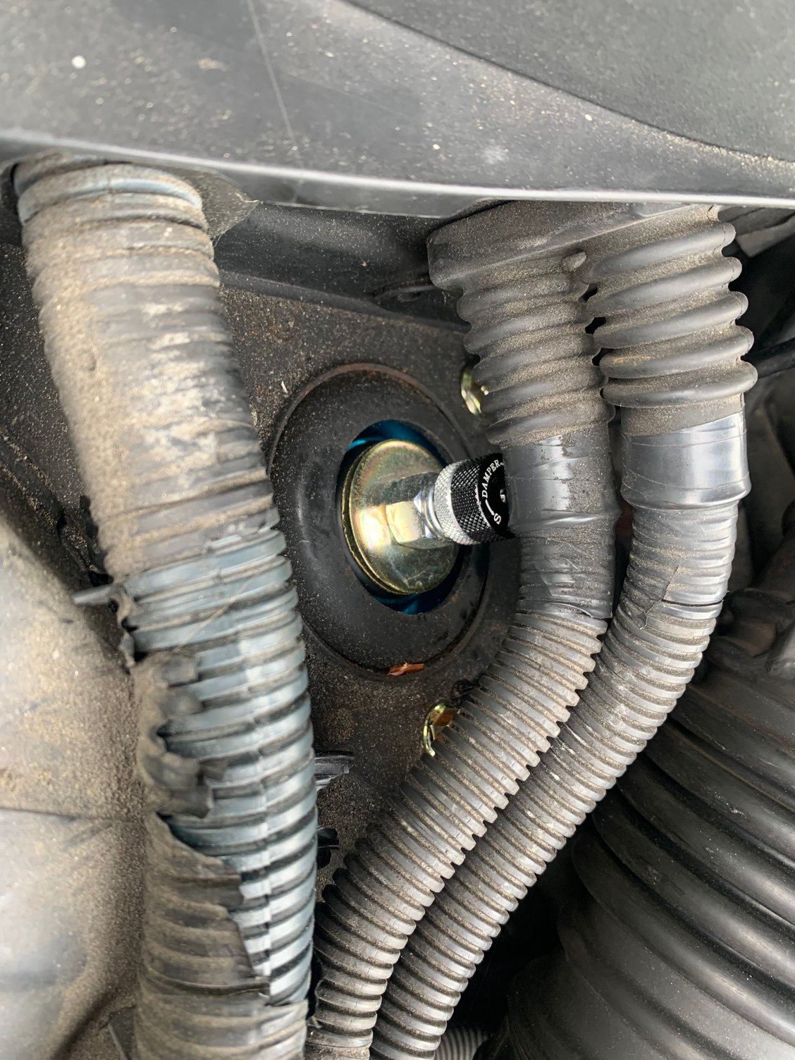

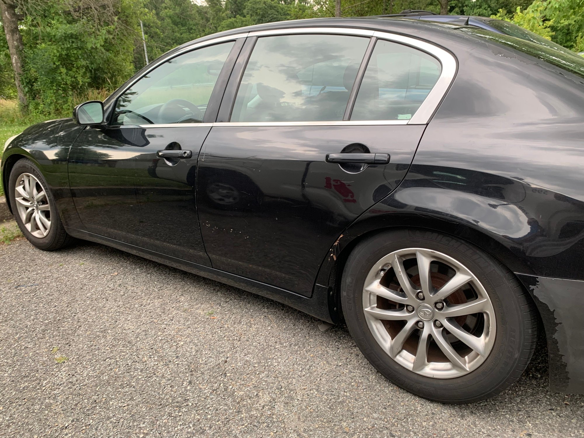

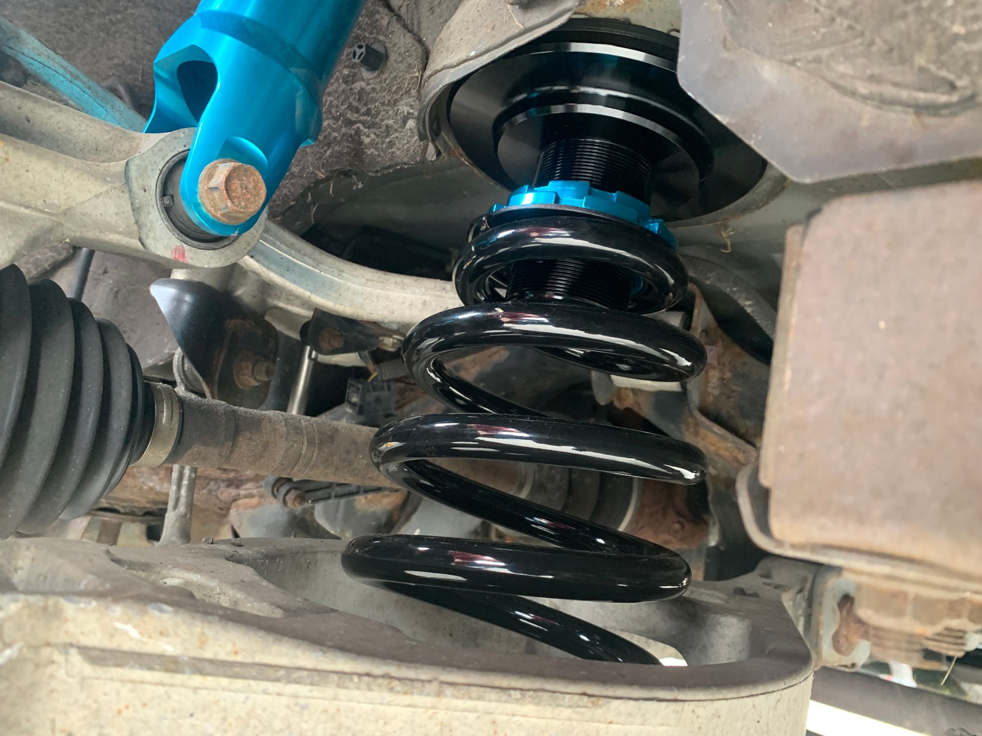

They do fit

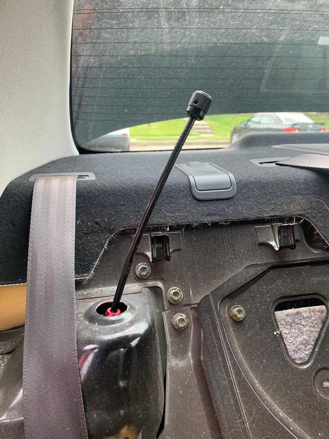

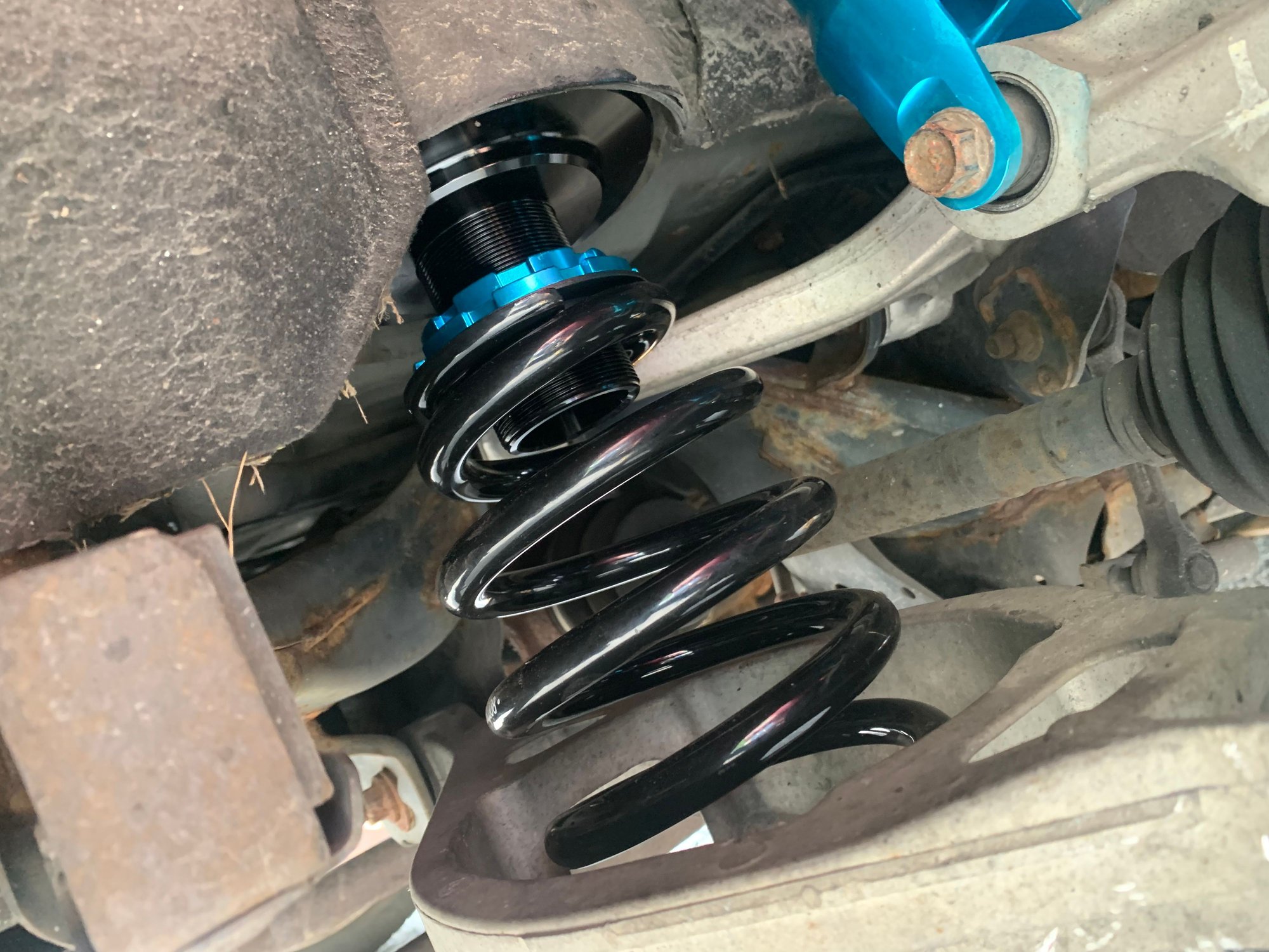

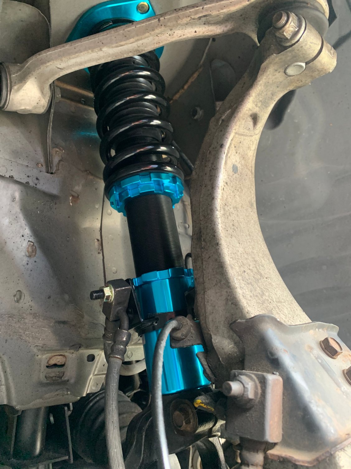

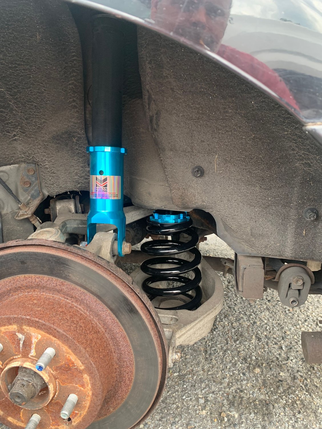

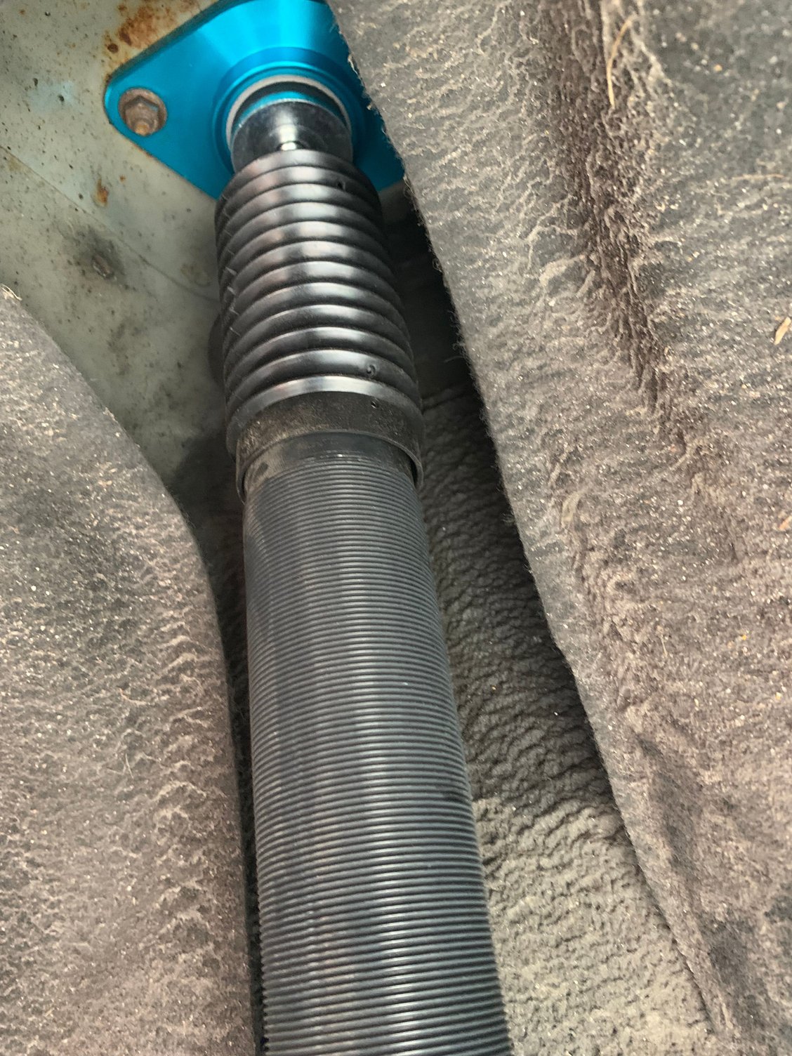

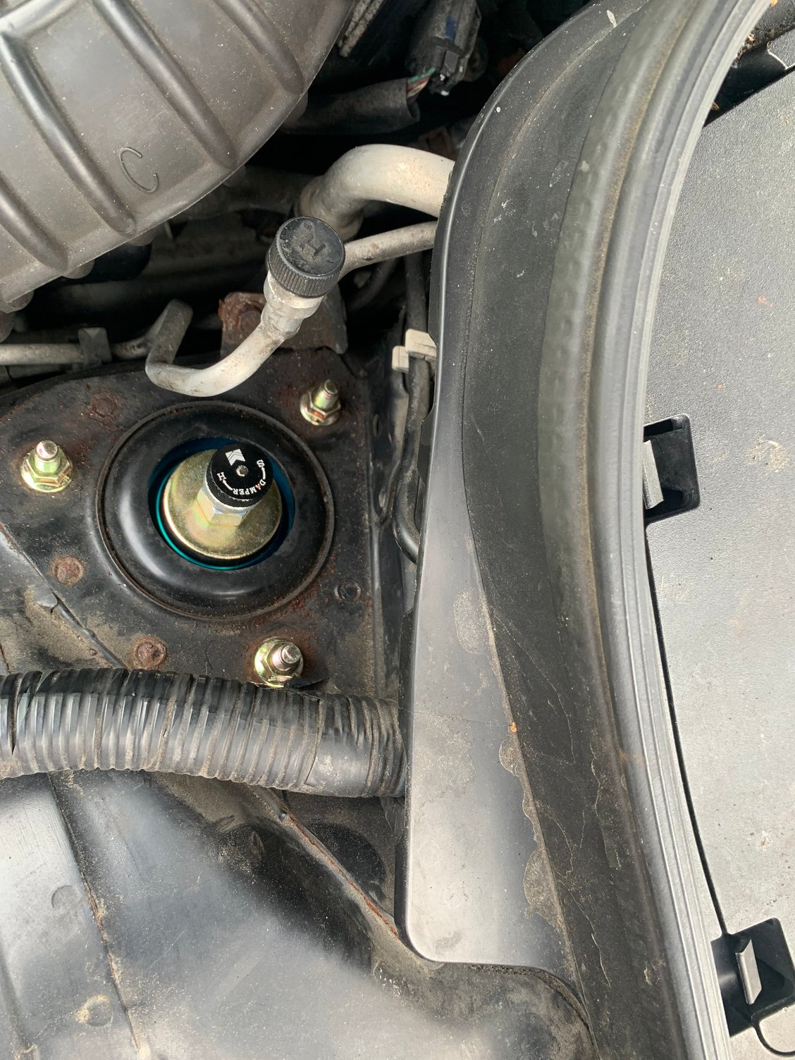

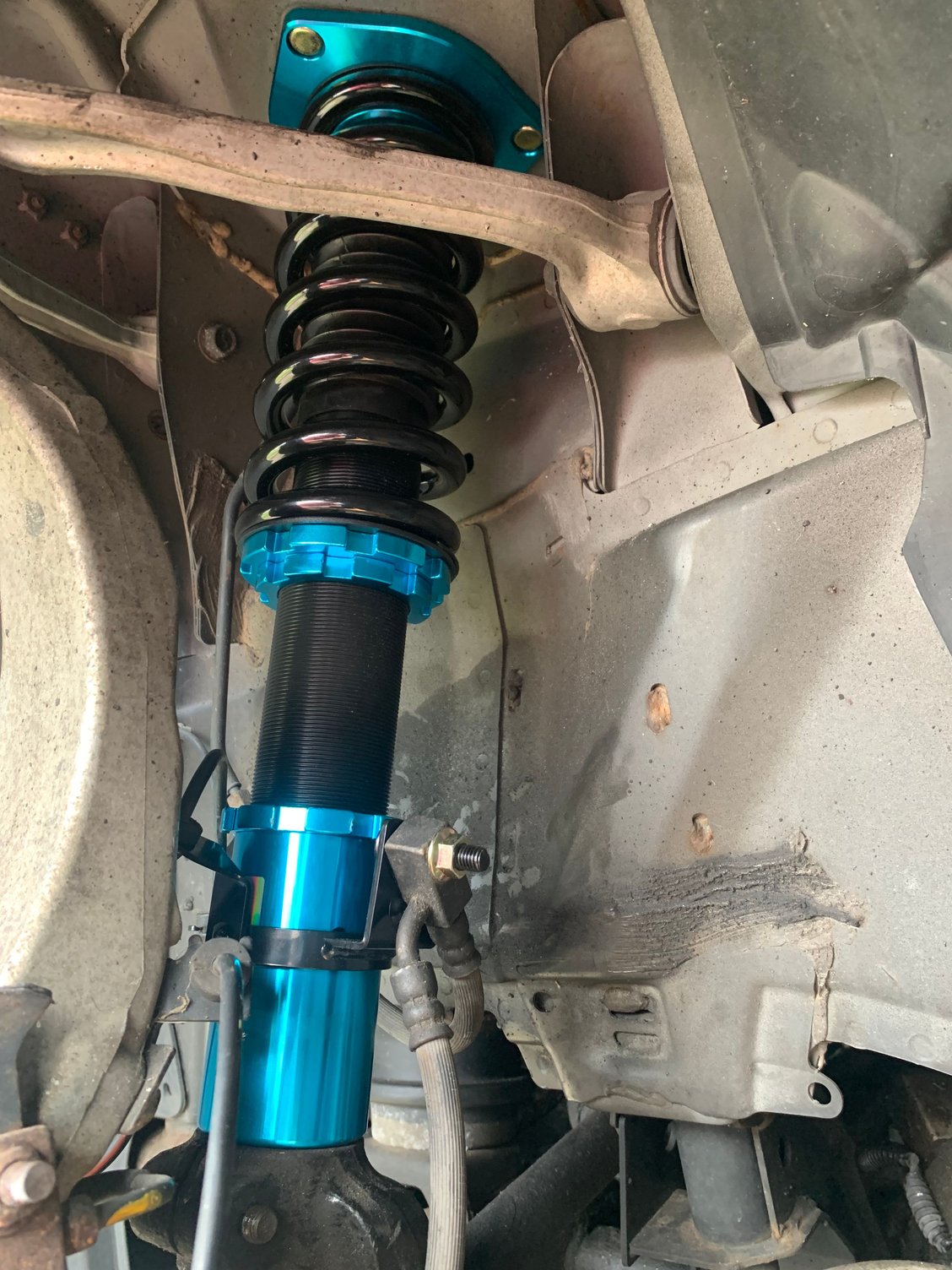

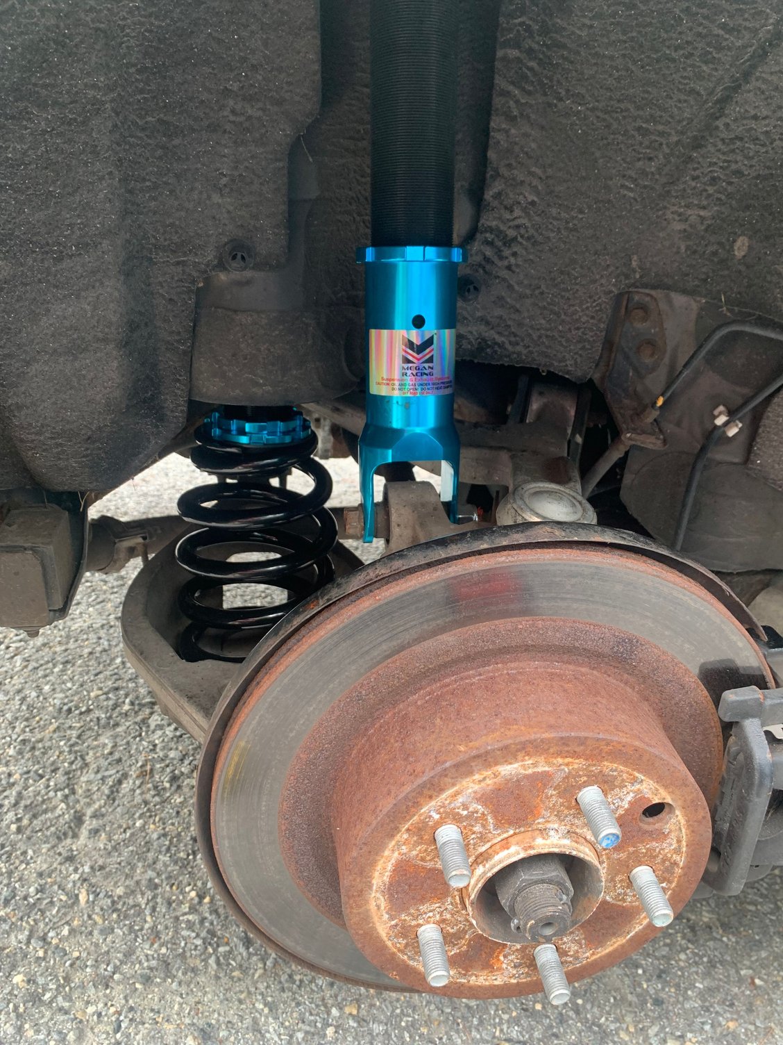

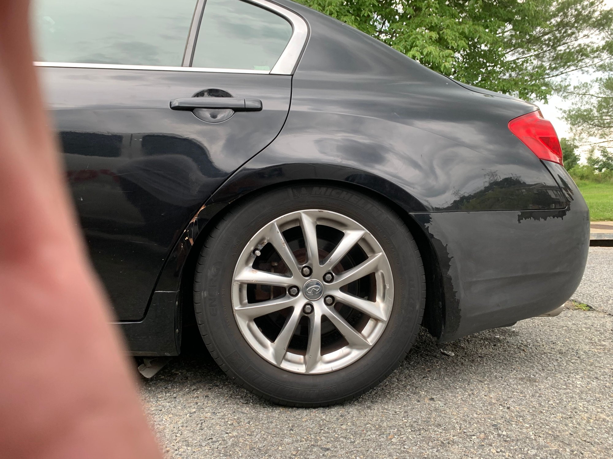

Ok to anyone that may be wondering I did pick up the coilovers and they fit with almost no issues so on the fronts the only issue was the bracket for brake line and sensor wire are a bit different you just have to adjust it so the sensor wire bracket on knuckle clears bracket on coilover that’s only issue I found there is also plenty of adjustment up and down for the rears the issue is the strut is about 1.5”-2” shorter so not much adjustment up but plenty down which was fine for me I liked where they sat and I had to drill holes for damper adjusters other then that they rode great on my test drive no rubbing in rear and camber is still pretty good I do still have to drop the about 1.5”-2” to match rear I will report back after I get some real drive time on them hope this helps someone somewhere somehow ty
