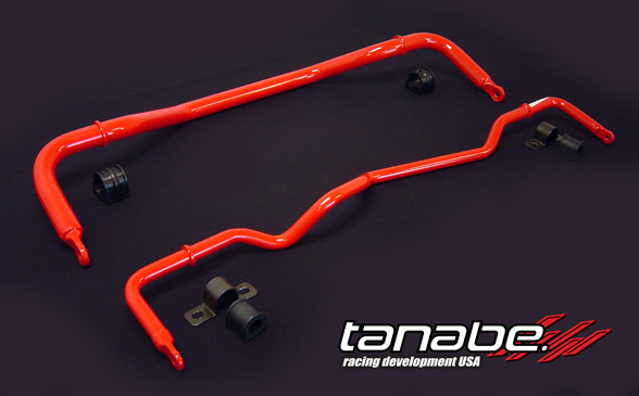

any infomation on the Tanabe sway?
http://www.tanabe-usa.com/images/photos/TSB063.jpg

Tanabe.... now, why didn't i think of that... looks like a good product, i see the collars are part of the sways, and they include the bushing thingies.
