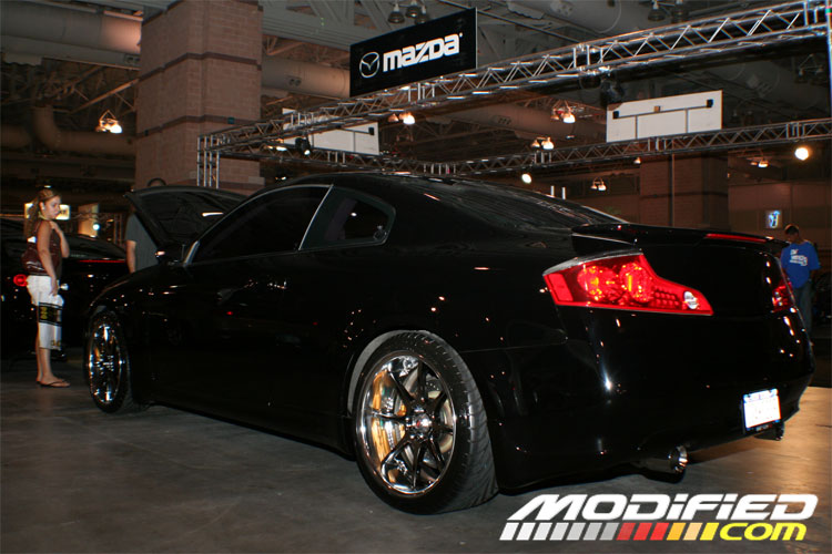

Wish I had better pics, but you can kind of see my crossdrilled/slotted rotors here behind my 17" race wheels:
Are those Brembo rotors? Also, how do those XDs hold up on the track...I am assuming these pics are from a track day, no?

Doesn't sound like it. Brembo does not make drilled and slotted rotors as direct OEM replacements. It's either one or the other.
