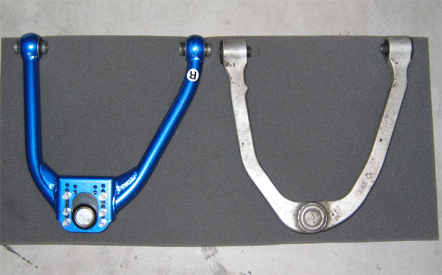

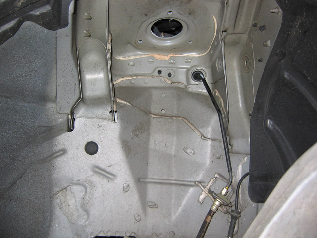

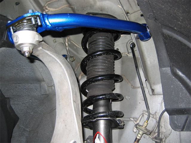

Well I installed my Cusco control arms today and it turned out I did have to remove the shock/spring assembly to get room to remove the two upper pivot bolts, but I still don't think I have to wait to get alignment. I didn't have to compress the springs to remove them and I'm pretty sure they've already settled all they're going to since it's been more than 2 weeks since I installed them. Tomorrow I'll be installing the SPC camber arms and toe bolts, then I'll get her aligned sometime next week. I'll post before/after numbers once it's all done. Here's a few pics of the install.
