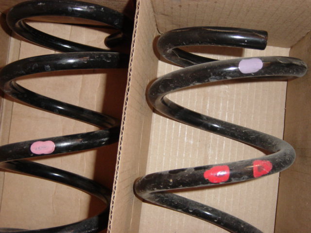

Hey guys. Just bought some 2005 OEM revised OEM Z springs and I wanted to make sure they are the revised ones. The rears have 2 red dots along with a single purple dot. The fronts have a pink dot on them. Are these the revised ones with the higher spring rates? TIA

That is also what I got on ’05 OEM Z springs.
On my350z.com forum someone (I think it was Gsedan35) posted:
The rear springs can be traced via a dial caliper, measure .57" and your holding a 04.5 rear springs, measure less and it's a 03/04 rear spring. Front springs did not change …
And
03 springs, have two red dot's with one white dot stamped on the springs.
04.5+ rear spring have a mauve colored dot (call it a pail purple, I dunno).

2 red
1 purple
These are def '05 350Z..
I know the car they came off of..

Originally Posted by inTgr8r
2 red
1 purple
cool. I'm sure they were but I wanted to make sure b4 I pay someone to put 'em on. Thanks for the replies.
And
Are these from an '04 with UNREVISED springs or did the guy who sold me these lie to me just to make a buck?! I specifically told him what I needed and he assured me that they were off his '04 and were the unrevised version.
Looking at the springs I was sent.... the smaller coils have one PINK or SALMON colored dot with a visible part number M3X01874 and the larger coils have 2 red dots and one white (yes white) with no visible part number.
