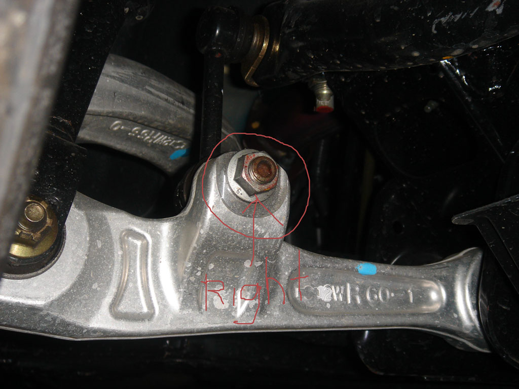

I've started to notice some squeeky noise when I go over speed bumps. Before it sounded really quiet, but lately i've been noticing it more. when I I go over, it sounds like the suspension is very loose.
and sometimes it sounds like sometime is scraping.
I went and looked under and I noticed on the left side, the the bolt isn't as far out compared to the right one. I turned it and it came right off.
The car is no more than 2 weeks old.
Attached Thumbnails Suspension Noise? W/ Pics-dsc00522a.jpg   Suspension Noise? W/ Pics-dsc00524a.jpg

Wow - that's not good. Good thing you got to it before it became something worse. Time to yell at the dealer..

hrmm... Strange. Never seen that loost before.
That is a nut for the sway bar link. Bring it in and we'll check it out!

Sounds so much better
Thanks Stan
