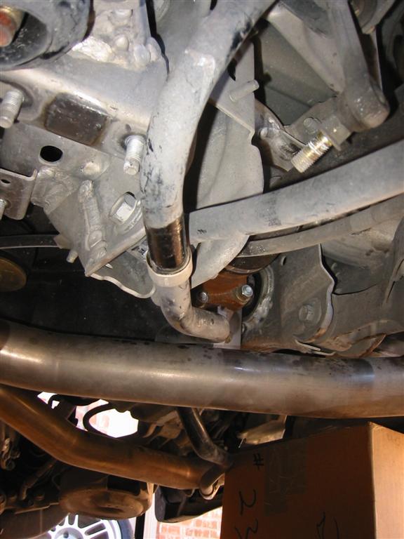

Front one, about 45 minutes. It's not difficult, but there are a lot of screws for the plastic cover to access the front sway bar.
Rear one, about 45 minutes to 1.5 hour depending on what kind of exhaust you have.
With a stock exhaust (or any exhaust that is not true dual) it is much easier, since you can unbolt the muffer from the mid pipe, lower the muffler. Then it is easy access to the rear sway.
With a true dual exhaust, you will need to figure a way to snake the the sway over one pipe and then under the other pipe. This is challenging but can be done (see attached looking under the car from the driver side).
I think this is why folks upgrade the sway bar before getting a new exhaust.

Attached Thumbnails Sway Bar Installation..How long?-g35-sway-005-large-.jpg

It took me total about 2 hours, with the HKS dual exhaust already on. I ended up having to undo the bolts on the HKS exhaust and let it hand, as well as remove both rear wheels in order to get more room to snake out the rear sway, and snake the new one in. Not too bad, though, especially since I enjoy working on my G.
